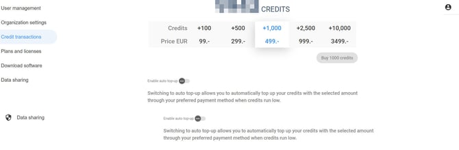

How do I purchase credits?
It is possible to buy credits from the Organization portal: https://account.pix4d.com/home.

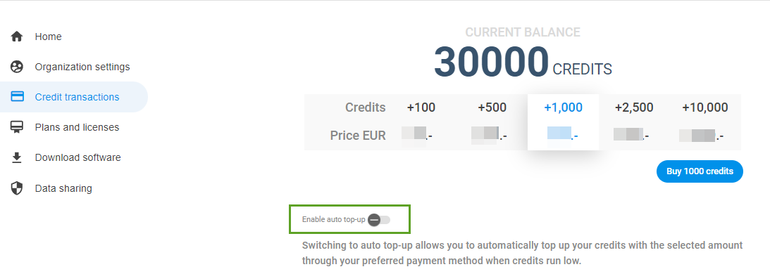

Can I purchase credits automatically?
PIX4Dcloud supports automatic credit top-up, which purchases additional credits when the balance falls below a defined threshold.
To enable auto top-up:
- Go to the Organization Dashboard at https://account.pix4d.com/home.
- Click Credit transaction.
- Click Enable auto top-up.
- Click Buy now.
Auto top-up is available only after the first manual credit purchase. The selected credit package is reused for future automatic purchases.
- Credits are automatically purchased when there are not enough credits to process a PIX4Dcloud dataset.

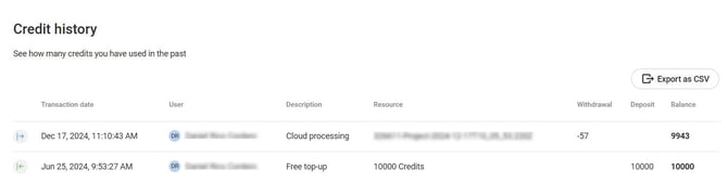

How can I check my credit history?
- Login with your PIX4D credentials at cloud.pix4d.com/login
Open Account Settings from the user menu.
Select the desired Organization dashboard.
- Click on Credit transactions in the left panel.

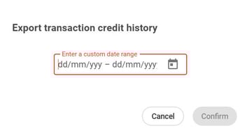

The credit history lists the transaction date, user, resource, and number of credits. The history can be exported as a CSV file for a custom date range.
Note that the date export format depends on the language selected in the account settings.
