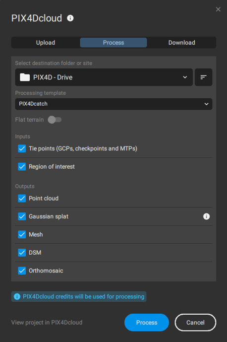

To access Process in PIX4Dcloud, navigate to File > PIX4Dcloud > Process in PIX4Dcloud... or  click direclty on PIX4Dcloud button
pix4dcloud_button
The Process in PIX4Dcloud window will pop up.
PIX4Dclod_process_2.6
The available Processing templates, Inputs, and Outputs are displayed in this window and explained in the table below:

After selecting the desired option in the Process in PIX4Dcloud window, click on Process to start processing.
