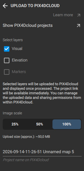

  1. Select Export from the right corner of the top bar.
  2. Click on the share__1_.png Share option to open the Upload to PIX4Dcloud menu.
  3. Select the layers, such as the orthomosaic (Visual), the surface model (Elevation), and annotations (Markers), to Upload to PIX4Dcloud.
    UploadToPix4Dcloud
  4. Define the output size of the layers by selecting between 25%, 50%, or 100% image scale output. 100% maintains full resolution, while a smaller image scale results in a smaller file size and a faster upload to PIX4Dcloud.
  5. [Optional] The name of the project is predefined by the name of the PIX4Dreact desktop project. The name can be modified before uploading.
  6. Click Continue.
