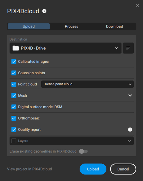

To upload to PIX4Dcloud:
  • From the File menu select the Upload to PIX4Dcloud... option or click on the PIX4Dcloud button pix4dcloud_button, found at the top-right corner of the PIX4Dmatic window.
Note: The Upload to Cloud feature will be disabled when the project consists of images only.
  • Select the project where the dataset will be uploaded.
  • Select the outputs for upload to PIX4Dcloud. The outputs that are available for upload are Images, Depth point cloud (for LiDAR PIX4Dcatch projects only), Dense point cloud, Depth & dense fusion (for LiDAR PIX4Dcatch projects only), Mesh, Digital surface model DSM, Orthomosaic, and Layers (geometries).
    PIX4Dclod_upload_2.6
Note: starting from version 1.80, meshes can be loaded in OBJ format, enabling direct download from PIX4Dcloud.
Starting from version 2.4.0, Gaussian splats can be loaded to PIX4Dcloud.
  • If the project has already been uploaded to PIX4Dcloud, the View project in PIX4Dcloud option will be enabled, allowing you to access the project directly in the cloud.
