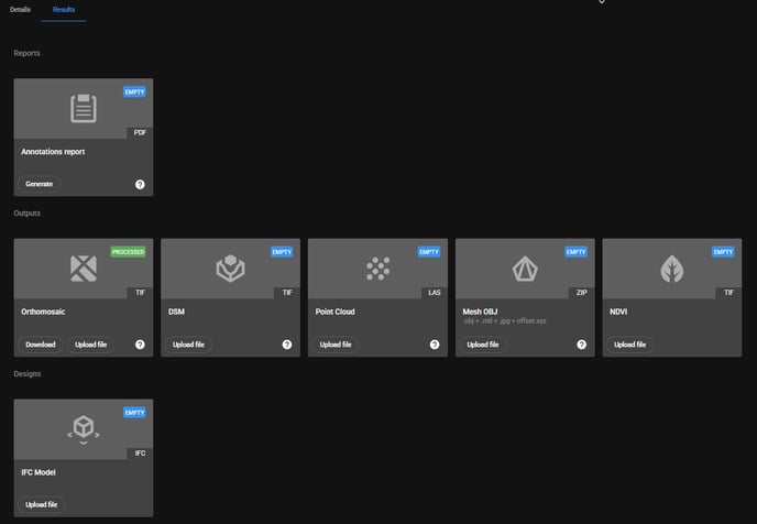

Results can also be uploaded directly from the PIX4Dcloud user interface. The following file types and size limits apply:
  • Orthomosaic: One GeoTIFF file, up to 50 GB
  • DSM: One GeoTIFF file, up to 50 GB
  • Index (e.g. NDVI): One GeoTIFF file, up to 50 GB
  • Point cloud: One LAS or LAZ file
  • 3D textured mesh: One OBJ file with associated MTL and JPG files
    • OBJ: Maximum 1 GB
    • JPG textures: Maximum 16,384 × 16,384 pixels

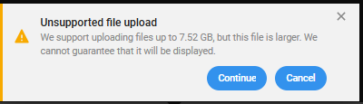

  • GeoTIFF files > 50 GB cannot be imported via PIX4Dcloud interface.
  • Files > ~7.5 GB may not display correctly in the web viewer, depending on file structure. A warning is shown if this occurs.
