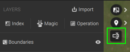

Can I search for an address or a GPS location?
Yes, you can search for an address or GPS coordinates by using the location icon. icon to locate adress or gps location
