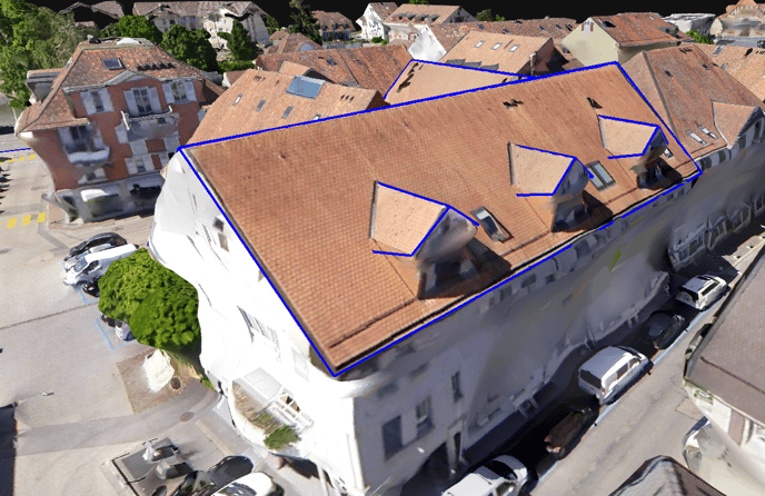

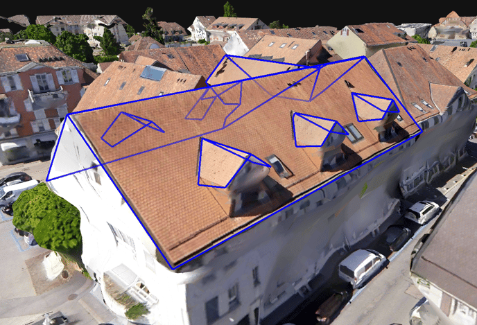

Object occlusion* 3 0 - 25.0 Display geometries above the 3D mesh.
View Perspective Perspective/
Orthographic
Changes the view in the 3D viewer.
Viewport layouts Single view Perspective/
Orthographic
View the scene from various angles simultaneously
Background
Sky background On On/Off Toggles on/off the sky background.
Background color Black Black/Grey/White Changes the background color.
Basemap
Map
Map/Satellite
Changes the basemap in the 2D viewer.
*Object occlusion:
Lower value
object2_1.78
Higher value
object_1.78
