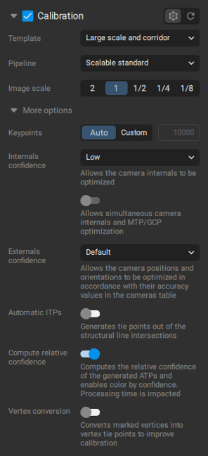

      Pipeline
      Pipeline defines how the camera's internal and external parameters are optimized.
      • Scalable standard (default): This calibration pipeline is a sequential pipeline that enhances image calibration for large datasets and fast processing.
      • Standard: This calibration pipeline is similar to Scalable Standard, but it is more robust, requires more processing time, and uses more PC resources.
      • Low texture planar: The calibration pipeline is intended for aerial nadir images with accurate geolocation and homogeneous or repetitive content of relatively flat terrain.
      • Trusted location and orientation: This calibration pipeline is intended for projects with accurate relative location and IMU data. For example, images taken with PIX4Dcatch in an indoor or outdoor setting or images from RTK or PPK drones or devices. All images must include information about the camera's initial position and orientation.

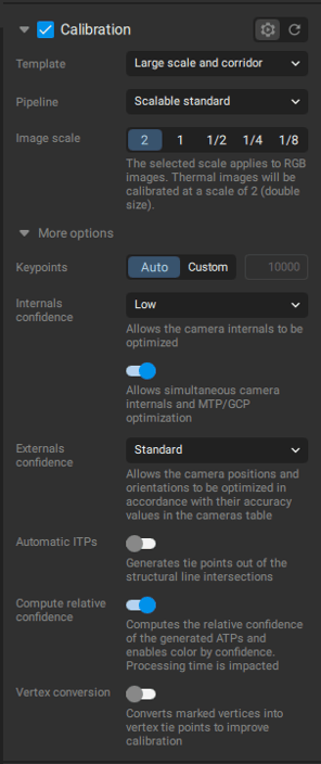

      Image scale
      Defines the image size at which keypoints are extracted. It is possible to select:
      • 2 (Double image size): Image scale for interior scene calibration template. Image scale automatically selected for thermal images.
      • 1 (Original image scale): This is the recommended Image scale.
      • 1/2 (Half image scale): This can be used to speed up processing and for cameras with very high resolution.
      • 1/4 (Quarter image scale): This can be used to speed up processing to get a fast overview and assess the completeness of the project.
      • 1/8 (Eighth image scale): This can be used to speed up processing to get a fast overview and assess the completeness of the project.
      Tip: Reducing the Image scale will usually result in a slightly reduced accuracy because fewer keypoints will be extracted. On the other hand, it can help to calibrate datasets with blurry images or datasets containing homogenous areas. We recommend reducing Image scale:

      More options
      Keypoints
      Control the number of extracted keypoints.
      • Auto (default): PIX4Dmatic automatically determines the optimal number of keypoints to extract.
      • Custom: Directs PIX4Dmatic to identify a specific number of keypoints, image content permitting.
        • Number of Keypoints: The targeted number of keypoints to be extracted per image.

      Internals confidence
      Defines how much the camera's internal parameters can be recalculated and adjusted during the project calibration:
      • Low (default):  Optimizes all internal camera parameters. This is recommended for cameras that are not included in the database or whose internal parameters require more precise adjustment.
      • High: Forces the internal parameters to remain close to their initial values. Depending on the circumstances, it is generally recommended to use this setting only when both of the following conditions are met:
        • The camera is already included in the database (providing more reliable initial values).
        • The scene geometry is such that it cannot properly constrain the internal parameters (e.g., nadir-only flights over flat terrain).
      • Absolute:  The initial parameters are fixed and excluded from the optimization process .
      toggle_switch_offAllows simultaneous camera internals and MTP/GCP optimization.
      When enabled, camera internals are optimized simultaneously with manual tie points (MTPs) and ground control points (GCPs). When disabled, camera internals are not optimized while optimizing MTPs and GCPs.
      In most cases, this setting does not require manual adjustment, as it is automatically enabled or disabled based on the selected processing template. For example, it is disabled by default when using the PIX4Dcatch template.
      However, disabling this option can be helpful in projects where conflicting positional data is present. This situation can arise when combining high-precision RTK/PPK imagery that contains outliers with GCPs. Although both the camera positions and GCPs may report high accuracy, conflicts can occur when one of the data sources is less accurate than assumed. These conflicts may cause the optimization process to over-adjust the internal camera parameters in an attempt to align the model with the GCPs. As a result, the model's quality may be significantly diminished, leaving many cameras uncalibrated or causing the calibration process to fail completely
      Note: This option is unavailable when internal confidence is set to Absolute.
      External confidence
      Defines how much the camera's external parameters can be recalculated and adjusted during the project calibration:
      • Standard. Allows the camera positions and orientations based on the accuracy of the camera table. It can be used by default; low accuracy can negatively impact the final alignment.
      • Absolute.  Do not optimize external parameters. Only available with the “Trusted location and orientation” pipeline.
      Starting in PIX4Dmatic 2.13, the former Low and Auto options have been removed. Their behavior is now covered by Pipeline strategy and General matching strategy
      • Low. Optimizes camera position and orientation when geolocation and orientation data are not very accurate. Processing is slightly slower but more robust.
      • Auto. Selected automatically by PIX4Dmatic after importing the images.

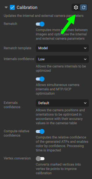

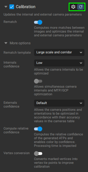

      Reoptimization
      Access:
      • In the menu bar, click Process > Calibration... > Reoptimization
      • Or select the Reoptimization button refresh after enabling the Calibration step and click Start.
      reoptimization_2.13
      This process is used to reoptimize already computed internal and external camera parameters. It can be used when changes to GCPs are applied after the Calibration step is completed.
      • Rematch type. Options are None and Default. This setting is only available if image features were saved during calibration, meaning Calibration was run in “Full processing” mode. Otherwise it is set to None. The rematch template is only applied when the rematch type is not None.
      • Rematch template. Rematch runs after the first part of the calibration. It uses the calibrated camera positions and the current 3D model to find new image pairs and add matches between images that are already calibrated, then optimizes the calibration again. It strengthens the reconstruction when the first matching found too few connections, such as with poor or missing GPS, flat low-texture scenes or mixed flights, and costs extra processing time.
      • Internal confidence
      • External confidence
      • Toggle on Compute relative confidence to compute the relative confidence of the generated ATPs and enable color by confidence. The default is set to off. This setting will have an impact on the processing time.
      • Toggle on Vertex conversion to use marked geometry vertices to improve the Calibration.
      Tip: Using the Reoptimization option reduces the processing time after applying changes to GCPs.
