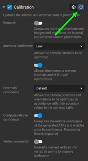

Reoptimization
Access:
  • In the menu bar, click Process > Calibration... > Reoptimization
  • Or select the Reoptimization button refresh after enabling the Calibration step and click Start.
    How to enable Reoptimize in PIX4Dmatic
This process is used to reoptimize already computed internal and external camera parameters. It can be used when changes to GCPs are applied after the Calibration step is completed.
  • Toggle on Rematch to compute more matches between images and optimize the internal and external camera parameters.
  • Internal confidence:
    • Low. Allows the camera internals to be optimized
    • High. Allows the camera internals to be optimized but to stay close to their initial values.
    • Absolute. Does not allow the camera internals to be optimized.
  • External confidence
    • Default.  Allows the camera positions and orientations to be optimized in accordance with their accuracy values in the cameras table.
    • Absolute.
  • Toggle on Compute relative confidence to compute the relative confidence of the generated ATPs and enable color by confidence. The default is set to off. This setting will have an impact on the processing time.
  • Toggle on Vertex conversion to use marked geometry vertices to improve the Calibration.
Tip: Using the Reoptimization option reduces the processing time after applying changes to GCPs.
