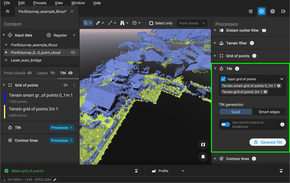

Input grid of points
The primary input for the TIN generation are points generated with the Grid of Points process. For more information and settings, please see the Grid of points article.
To select the Input grid of points:
  • In Processes - TIN, select the generated grid of points in the drop-down menu.
Tip: It is possible to select more than one grid of points. This is particularly helpful in case it is needed to have different TIN resolutions in different areas.
TIN generation algorithms
It is possible to generate the TIN by choosing two algorithms:

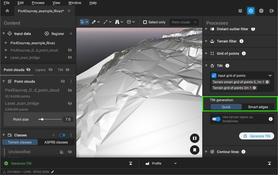

  • Quick: Triangulates all the grid points together, even on edges, resulting in a convex border fitting holes on the grid's edges.

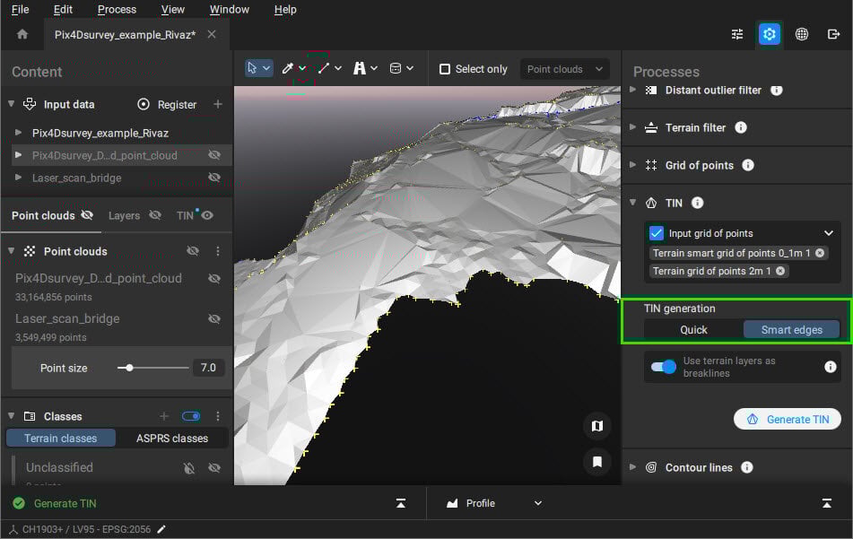

  • Smart edges: Involves extra post-processing by trying to build a border that fits more closely the shape of the grid points (a concave shape), and remove all the TIN triangles that are outside of this border.

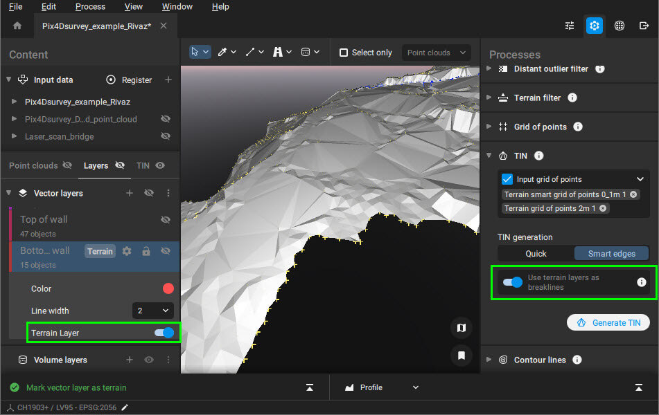

Use terrain layers as breaklines
  • Use terrain layers as breaklines (Enabled - default): This feature allows the use of polyline, polygon, and marker object types as breaklines if the vector layer is defined as a terrain layer. All layers with the tag Terrain are used.
To define a layer as a Terrain layer:
  • In the Content - Layers, right-click on the layer.
  • Click Mark as Terrain layer.
Alternatively, it is possible to
  • Open the Layer Properties by clicking on the gear button.
  • Toggle the Terrain Layer switch.

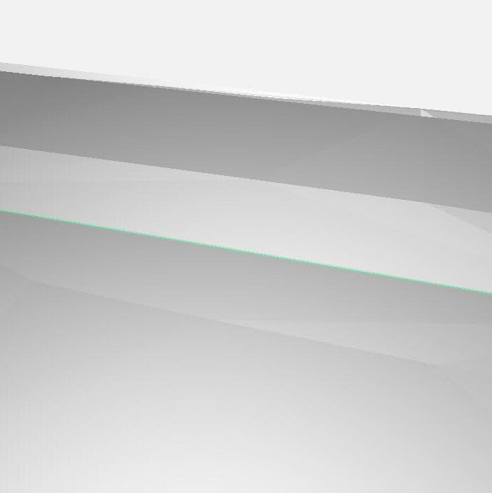

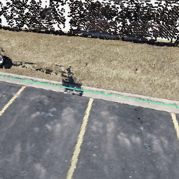

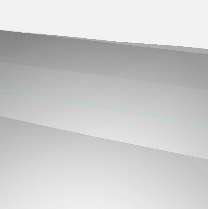

Example: The vectorized curb in the parking lot can be used as a breakline for the TIN generation:
TIN generated from the grid of points and the curb as a breakline.

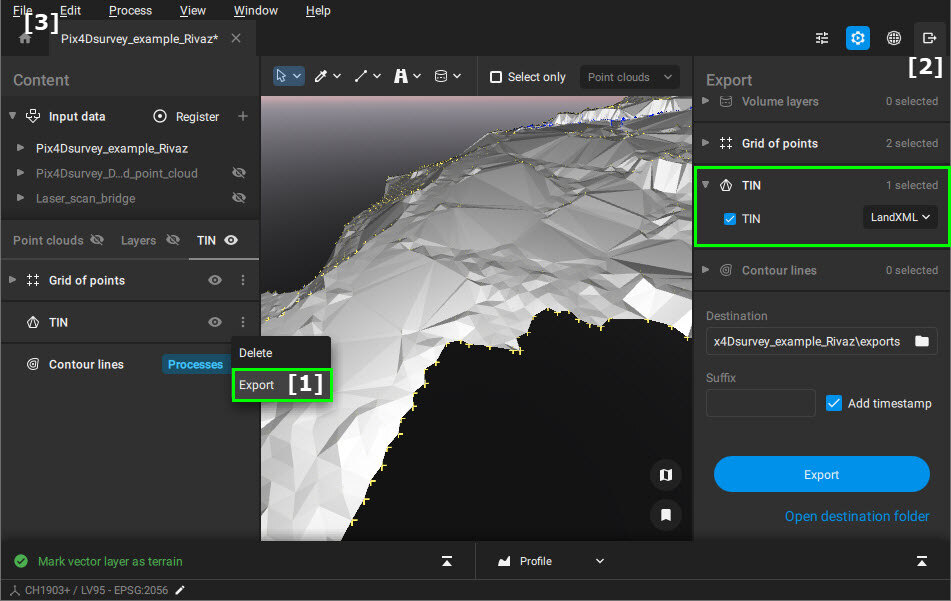

エクスポート
The generated TIN can be exported in LandXML format or in raster GeoTIFF format (.tif) using the following methods:
  • [1] In the Content - TIN panel, click Export or
  • [2] On the top right, click the export icon export.jpg または
  • [3] From the menu bar, click File - Export.
