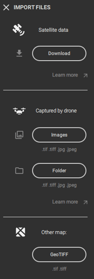

Import satellite images
The first option when starting a project is to import Satellite data. Click Download to be able to access Sentinel 2 data. For more information: Satellite data in PIX4Dfields.
Import drone images
To import images captured by drone:
1. Click Images to select several images or click Import folder to import a complete folder at once.
Note: It is possible to import images (.tif, .tiff, .jpg, .jpeg). For more information: Inputs and outputs.
2. Select the images or folder and click Open.
3. In PIX4Dfields, projects with RGB, multispectral or thermal images can be created.
4. The Processing options menu appears. To find out more information about these settings please go Processing options. After selecting the desired Processing options, click Apply
5. Click Import images or Import folder in case more images need to be added.
Note: If a camera is not supported in Pix4Dfields, it can still be processed. For more information: Your camera is not supported at this time - PIX4Dfields
The IMPORT DETAILS of the images including location, size of the dataset, and acquisition time and date appear on the left sidebar. If importing multispectral images a message will display stating whether reflectance targets could be found.
6. A settings icon will appear beside the Start processing button. Click on it in case the Processing options need to be changed.

Import an orthomosaic as GeoTiff
An orthomosaic can be imported by selecting GeoTIff under Other Map.
