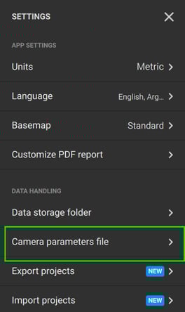

- On the dashboard, go to
SETTINGS on the top-right and click Camera parameters file.
- Click Select file and select the .xml file in the file dialog.
- Exit the settings and create a project to process the dataset. The camera parameters file is used automatically.

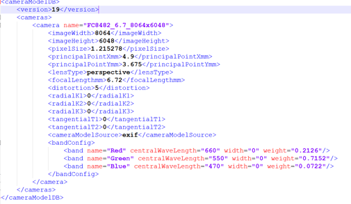

- Ensure the provided XML has the correct format:

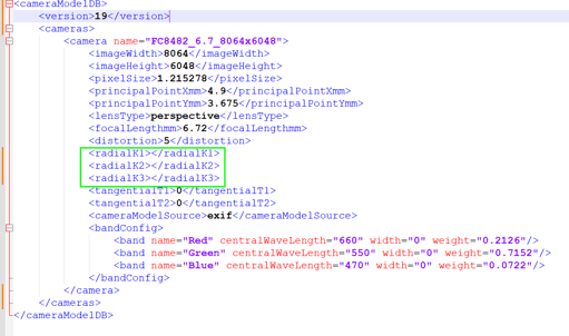

- Ensure there are no empty tags:
- Ensure there are no incomplete tags like <rigs/> at the beginning or <mappings/> at the end.
