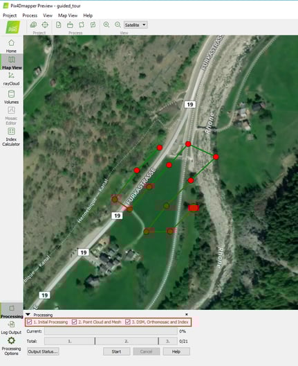

  1. In PIX4Dmapper, click View > Processing.
  2. In the processing bar at the bottom, enable all three processing steps.
    (View > Processing)

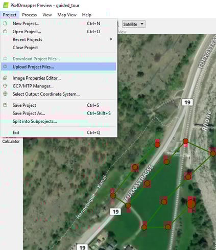

  3. Click Project > Upload Project Files….

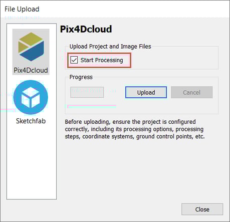

  4. In the File Upload window, enable Start Processing (if available).
    • Note: This option is not available in PIX4Dmapper version 3.0.18.
      In that case, processing must be started manually in PIX4Dcloud.
  5. Click Upload.
