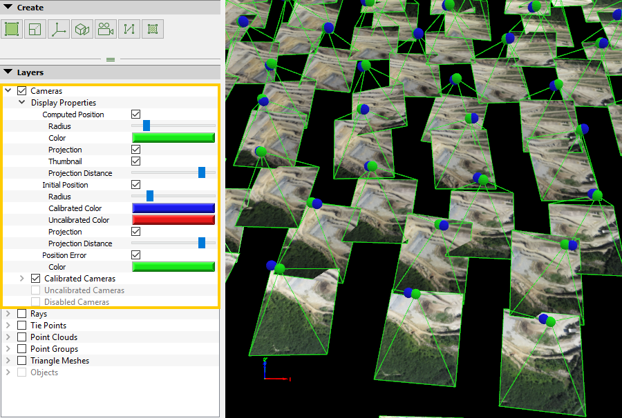

Display Properties
The Display Properties layer allows to edit the display properties for all the cameras. The following properties can be edited:
  • Computed position: View/hide the calibrated (optimized) camera position sphere (this property affects only the Calibrated cameras).
    • Radius: Increases/decreases the computed camera positions' sphere radius (this property affects only the Calibrated cameras).
    • Color: Selects the computed camera positions' sphere color, the color for the projection lines (between the computed position and the corners of the thumbnails) and the color for the thumbnails borders(this property affects only the Calibrated cameras).
    • Projection: View/hide projection lines between the computed camera positions and the thumbnails (this property affects only the Calibrated cameras).
    • Thumbnail: View/hide the thumbnails of the original images (this property affects only the Calibrated cameras).
    • Projection Distance: Increases/decreases the distance between the computed camera positions and the thumbnails (this property affects only the Calibrated cameras).
  • Initial Position: View/hide the initial camera position sphere.
    • Radius: Increases/decreases the initial camera positions sphere radius.
    • Calibrated Color: Selects the initial camera positions' sphere color for the Calibrated Cameras (cameras used for the reconstruction).
    • Uncalibrated color: Selects the initial camera positions' sphere color for the Uncalibrated Cameras (cameras not used for the reconstruction).
    • Projection: View/hide projection lines between the computed camera positions and the hypothetical thumbnails (the thumbnail box appears but empty).
    • Projection Distance: Increases/decreases the distance between the computed camera positions and the hypothetical thumbnails.
  • Position Error: View/hide a line between initial and computed camera positions (this property affects only the Calibrated cameras).
    • Color: Color for the line between initial and computed camera positions (this property affects only the Calibrated cameras).
