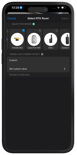

With the mobile device and the RTK device connected, tap the GPS signal indicator at the top right corner of the interface and select RTK via Bluetooth.
         RTK card

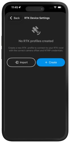

Once the RTK Device Settings dialog opens, connect to the RTK device in PIX4Dcatch.
Tap Devices Discovered - Tap to Select
Plantilla Iphone (1)-2

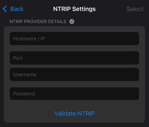

If a profile already exists, select the desired profile and click Connect to use the NTRIP credentials previously entered.
If no profile exists, select Import or Create RTK Profile as required.
For information about the RTK profile template, click here.
