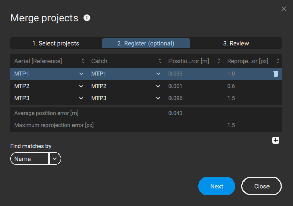

  8. The Register window will be displayed. This step is optional to match shared Tie points (GCPs or MTPs) if used.
    merge2_1.78
  9. (Optional): Select at least three Tie points from the first project and match the respective Tie points from the second project. The Reprojection error [px] will be calculated for each share Tie point.

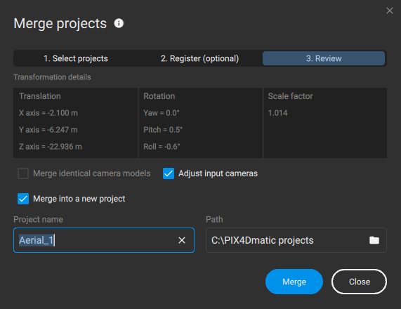

  10. The Review window will be displayed.
  11. Transformation details (Translation, Rotation, Scale factor) about the two projects to be merged will be calculated.
    merge3_1.78
  12. (Optional) Merge identical camera models: This option will merge identical camera models in the camera table of the merged project.
  13. (Optional) Merge into a new project: This option will create a new project that will merge the two existing projects.
  14. (Optional) Adjust input cameras: This option aligns the input camera information from the two projects.
  15. Click Merge.
