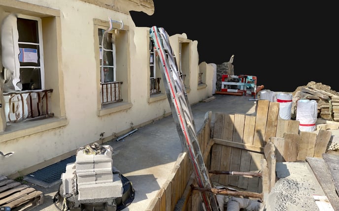

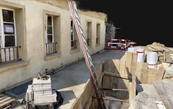

Gaussian Splatting is a novel technique for 3D scene reconstruction and rendering that represents a scene as a collection of 3D Gaussians rather than traditional meshes or pointclouds. It allows for highly detailed 3D models with photo-realistic rendering.

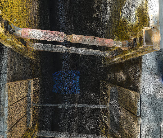

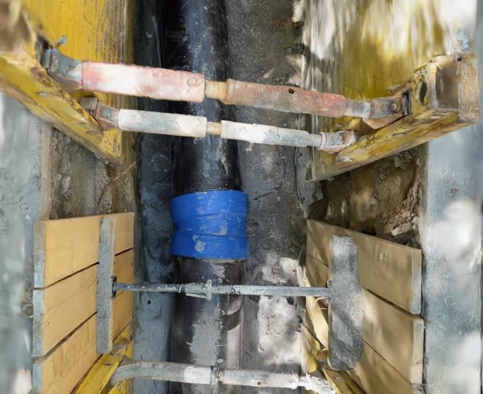

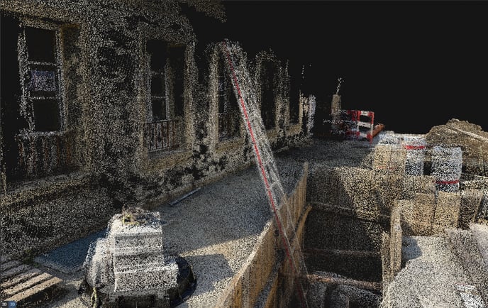

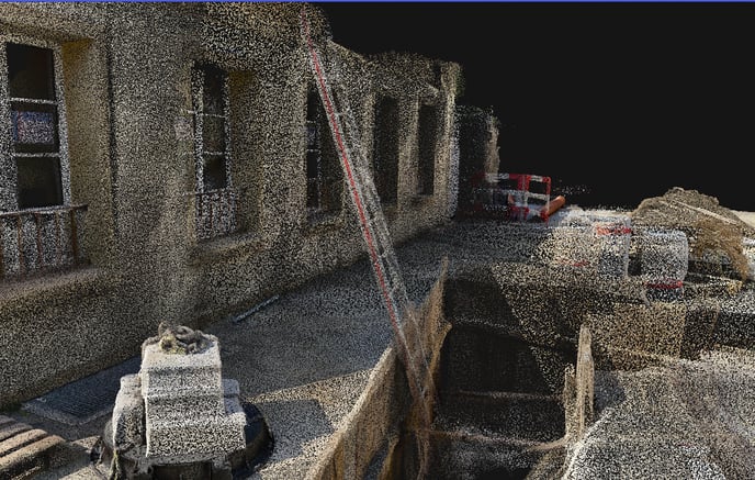

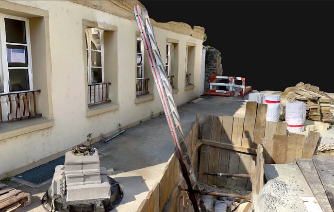

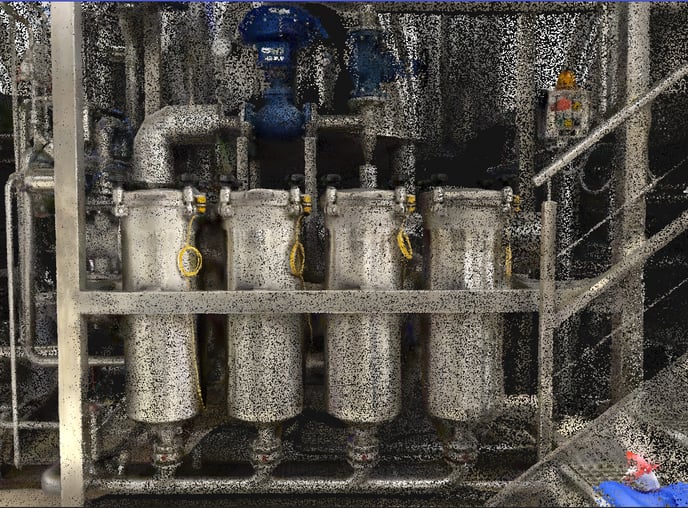

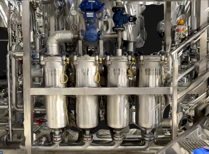

At PIX4D, we combine the strengths of Gaussian Splatting with the reliability and actionability of traditional photogrammetry outputs. Our processing pipeline generates an accurately scaled and georeferenced Gaussian Splatting model, while also producing a point cloud and a mesh built from this model, which benefits from Gaussian Splatting’s ability to reconstruct finer details.
Which projects benefit from the Gaussian Splatting Technique

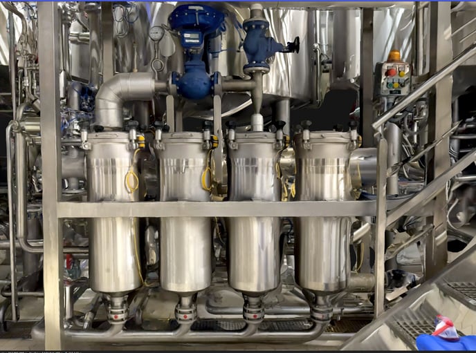

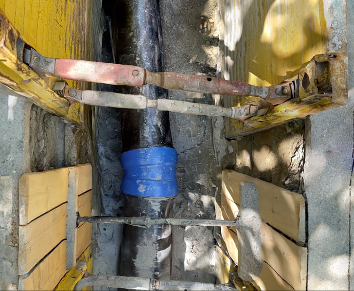

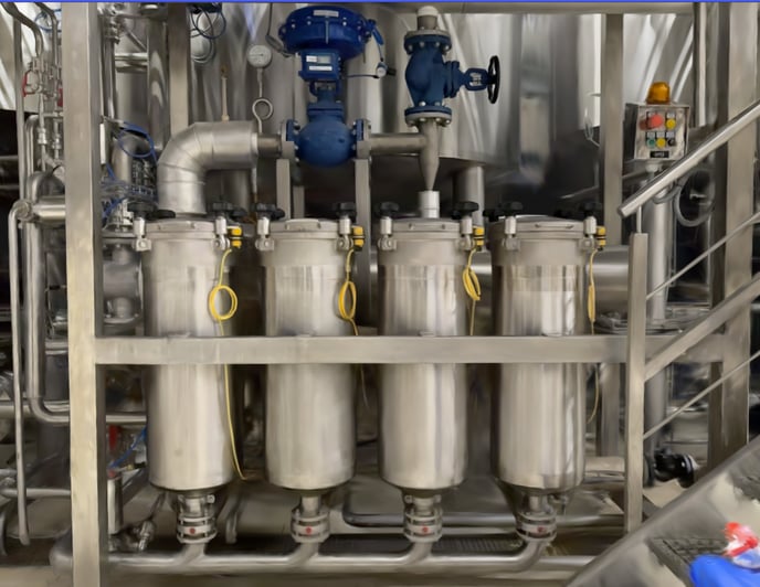

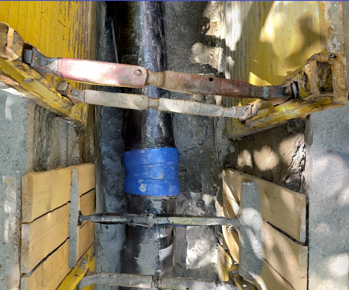

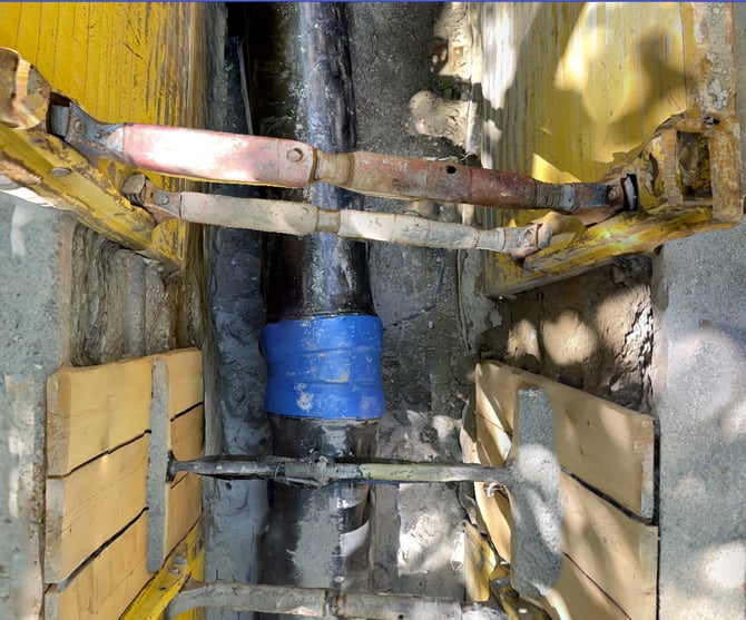

The Gaussian Splatting technique significantly enhances the accuracy and realism of 3D modeling, particularly when dealing with objects that have intricate geometric details and fine structural elements.

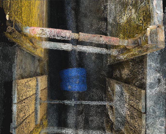

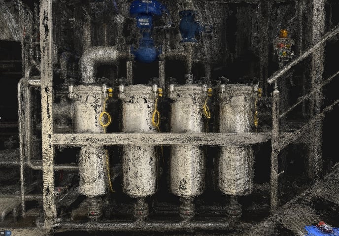

This technique is especially effective for capturing complex shapes, which are often challenging to represent using more traditional approaches. Additionally, it excels in handling thin structures like pipes, wires, and other elongated elements that require high precision to avoid visual artifacts or loss of detail.
This technique provides a smoother, more continuous representation of object surfaces, improving visual fidelity.

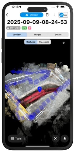

Save and Review
Save the project and review the capture report to check image quality and ensure adequate scene coverage.

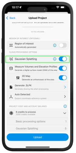

How to select Gaussian Splatting as an output
Once the project is created, Gaussian Splatting can be selected when uploading to PIX4Dcloud.
To generate the Gaussian Splatting model, follow the next steps:
- Go to the Project folder and select the project.
- Tap Upload.
- Select the upload location.
- Tap Next.

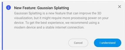

- In the Cloud processing options, turn on Gaussian Splatting.
6. Tap the Upload button
Credit Consumption

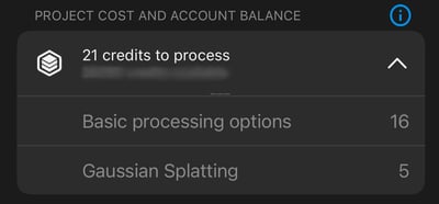

Processing with Gaussian Splatting requires additional processing power and time. Therefore, any project using this technique incurs an additional fee of 5 credits, regardless of the number of images.

The project can be accessed in PIX4Dcloud like any other project. If Gaussian Splatting was selected as an output in PIX4Dcatch, the project hierarchy will include a new 3D output called Gaussian Splat. This layer is not displayed by default. The Gaussian Splat model can be downloaded.
Turn on the Gaussian Splat layer to visualize it.
