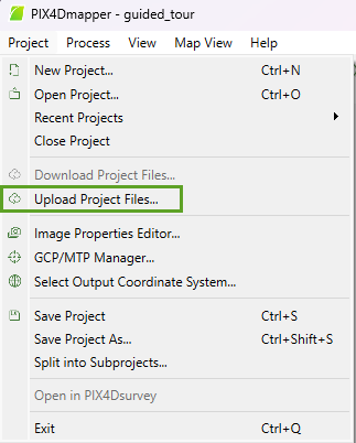

  • PIX4Dmapper datasets uploads to PIX4Dcloud Starter/PIX4Dcloud Pro for processing:
    •  The "Upload Project Files..." button is still available in PIX4Dmapper, but projects uploaded to PIX4Dcloud are processed as follows: ojects uploaded to PIX4Dcloud will be processed with the following changes:
      Upload project files
      • Processing:  Datasets are processed with the new pipeline using a nadir or oblique template.
      • Cloud Input:  Only the input images, the CRS from the .p4d file and, if present, GCPs/Marks are used.
      •  Important: All other settings in the .p4d file are ignored.
        • No custom settings are applied.

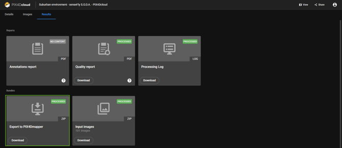

  • PIX4Dmapper datasets uploads +  PIX4Dcloud Starter/PIX4Dcloud Pro processing + Export to PIX4Dmapper from PIX4Dcloud:
    •  The "Export to PIX4Dmapper" option (zip download) is no longer available in PIX4Dcloud Starter/PIX4Dcloud Pro.

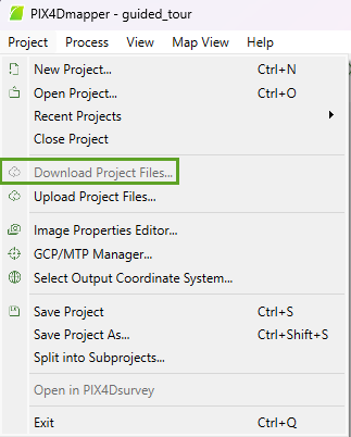

  • PIX4Dmapper datasets uploads + PIX4Dcloud Starter/PIX4Dcloud Pro processing + Download Project Files.. from PIX4Dmapper:
  •  The "Download Project Files..." button in PIX4Dmapper is greyed out for projects processed in PIX4Dcloud since February 28, 2026.
Download project files
