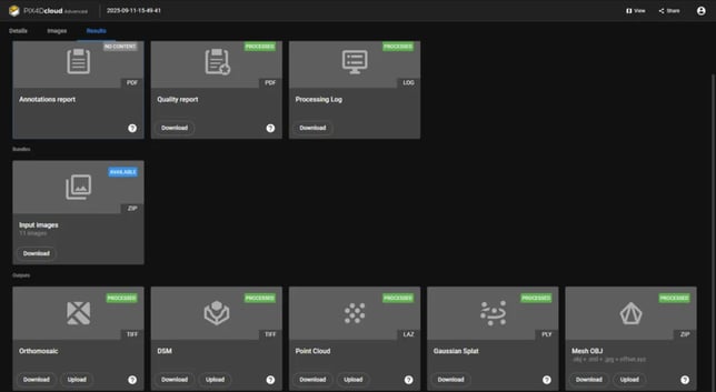

How to Download the Gaussian Splat Model
To download the Gaussian splat model file:
  1. Open the project in PIX4Dcloud.
  2. Navigate to the Files & Reports section.
  3. Under Gaussian splat, click Download to retrieve the file.
    download gaussian
