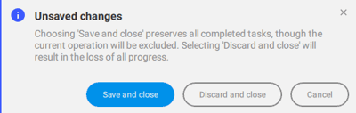

Note: since version 2.4.0, processing can be paused and resumed at any time as long as the project remains open. There is no need to cancel and start over. If processing is paused and the project is about to be closed, the following message will appear.
Captura de pantalla 2026-04-20 132137

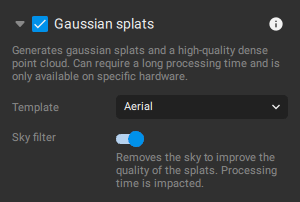

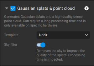

Depending on the dataset, the appropriate template should be selected:
    • Nadir. Template optimized for aerial datasets captured with nadir drone imagery.
    • Oblique. Template optimized for aerial datasets captured with oblique drone imagery.
    • PIX4Dcatch. Template optimized for projects captured with PIX4Dcatch. It is highly recommended to enable the sky filter option to improve the quality of the results.
    • Mixed. Template intended for mixed datasets that combine aerial imagery and PIX4Dcatch acquisitions.
    gspcls_2.6.0
