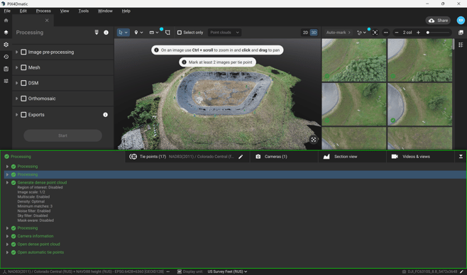

The status center displays tracking notifications and progress reports of different processing steps. In addition, it allows easy access to the Tie points (GCPs, MTPs, and Checkpoints), Cameras, Section view, and Videos & views.
How to access the status center in PIX4Dmatic
  1. In the Menu bar click in View > Control Panels > Status center.
  2. The status center is displayed as a panel divided into two sections:
    • On the left, the Console tab.
    • On the right, the Tie points tab.
status center
Note: The Status Center can be collapsed to maximize workspace visibility, providing a clearer view of the project.
  • To expand the Status Center, click up.png.
  • To collapse the Status Center click down.png.

Console panel in PIX4Dmatic
The Console Panel is used to track and display the progress of actions and processes within a project. By default, it remains collapsed, showing only the latest activity. Expanding the panel reveals a complete list of activities.
There are five status levels that can appear in the console panel:
  • check.png Successful item: Process/action is successful.
  • warning.png Warning item: Cautionary advice.
  • error.png Error item: An error occurred during processing.
  • info.png Information item: An action is taking place (e.g., reading file, loading file, etc.).
  • canceled.png Canceled item: An action is canceled.
