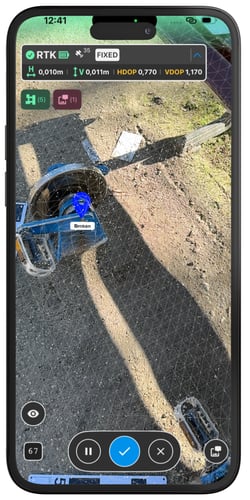

  1. Tap the record button record icon and begin moving the device slowly. The app will automatically start capturing images according to the selected settings.
    record screen
               OS and Android devices with LiDAR or ToF sensors can use the Live Preview feature eye icon to                 gain insight into what is being captured.
          2. If necessary, tap the pause button pausa icon to pause the recording. Tap the record button to                        resume recording.
            capture screen
 Important: Use the pause button only when absolutely necessary. To ensure accuracy,     remain in a static location and limit pauses to under 20 seconds.

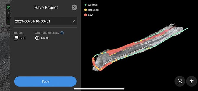

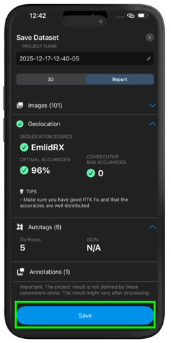

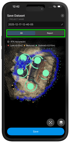

          4. A capture report will be displayed for quality assurance review. The 3D tab shows the 3D                 view and in the Report tab shows information about the quality of the capture.
         tabs view
             The 3D tab displays the following information:
  • Project Name.
  • center button Tap to center the project.
  • layer button Tap to access:
    • cameras button Toggle the camera positions visibility.
    • pointcloud button Toggle Sparse point cloud. Available for devices with a TOF and/or LiDAR sensor. Tie points will be displayed for devices without these sensors.
    • close button Close the menu.
    The Report tab displays the quality of the capture before saving the project. For more information, click here.
        5. Tap Save to store the completed project locally on the device, making it available for later                   processing.
