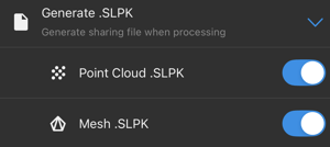

SLPK
SLPK files are optimized for efficient streaming and visualization of 3D datasets of both point clouds and meshes in ArcGIS Online and ArcGIS Pro.
To generate a Point Cloud and/or Mesh with SLPK, enable the option Point Cloud .SLPK and/or Mesh.SLPK
          slpk

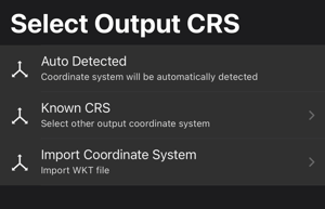

Output Coordinate Reference System
The processed datasets may be georeferenced using one of the following options:
  • Autodetected: Automatically assigns the CRS based on the UTM zone associated with the mobile device’s position.
  • Known CRS: Selects a specific CRS from the internal database by searching for its name or EPSG code.
  • Import Coordinate System: Imports a custom projected coordinate system defined by a Well-Known Text (WKT) file. For more information:  Well-Known Text(WKT) in PIX4Dcatch.
For additional information: Output Coordinate Reference System - PIX4Dcatch
          select crs
