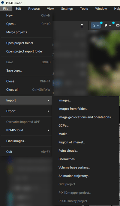

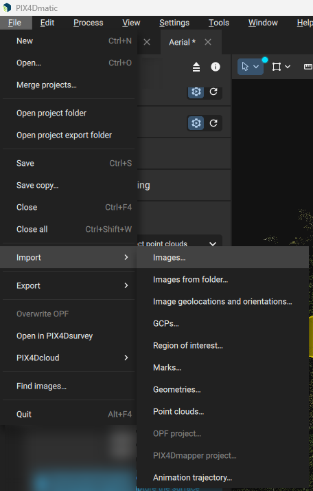

Inputs - PIX4Dmatic
This article provides a comprehensive list of all supported input file types in PIX4Dmatic, including their formats and descriptions.
