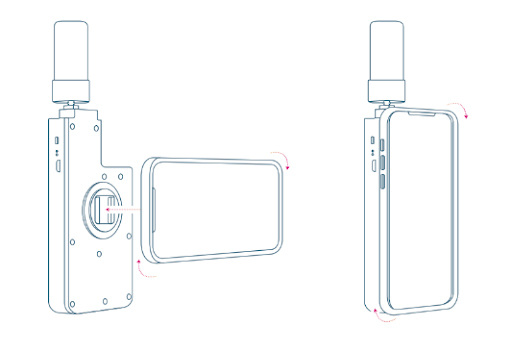

First, insert the phone into its compatible SP-connect case. Then, mount the case to the RTK device by following the instructions provided with the SP-connect case.
Important: Ensure proper orientation of the mobile device after mounting it to the viDoc distributed by PIX4D with the antenna pointing up.

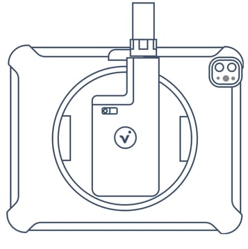

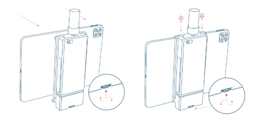

Insert the tablet into the suitable SP-connect case. After that, secure the case to the RTK device by following the guidelines provided with the SP-connect case, ensure the table is in landscape mode
Holder with clamp:
Loosen the screw on the bottom of the viDoc distributed by PIX4D, and carefully insert the tablet into the clamp. Use the iPad's magnets to center the viDoc distributed by PIX4D. Tighten the screw to secure the tablet, and ensure that the tablet is in landscape mode.

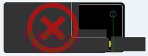

* Warning: This configuration is not recommended due to partial camera sensor occlusion.

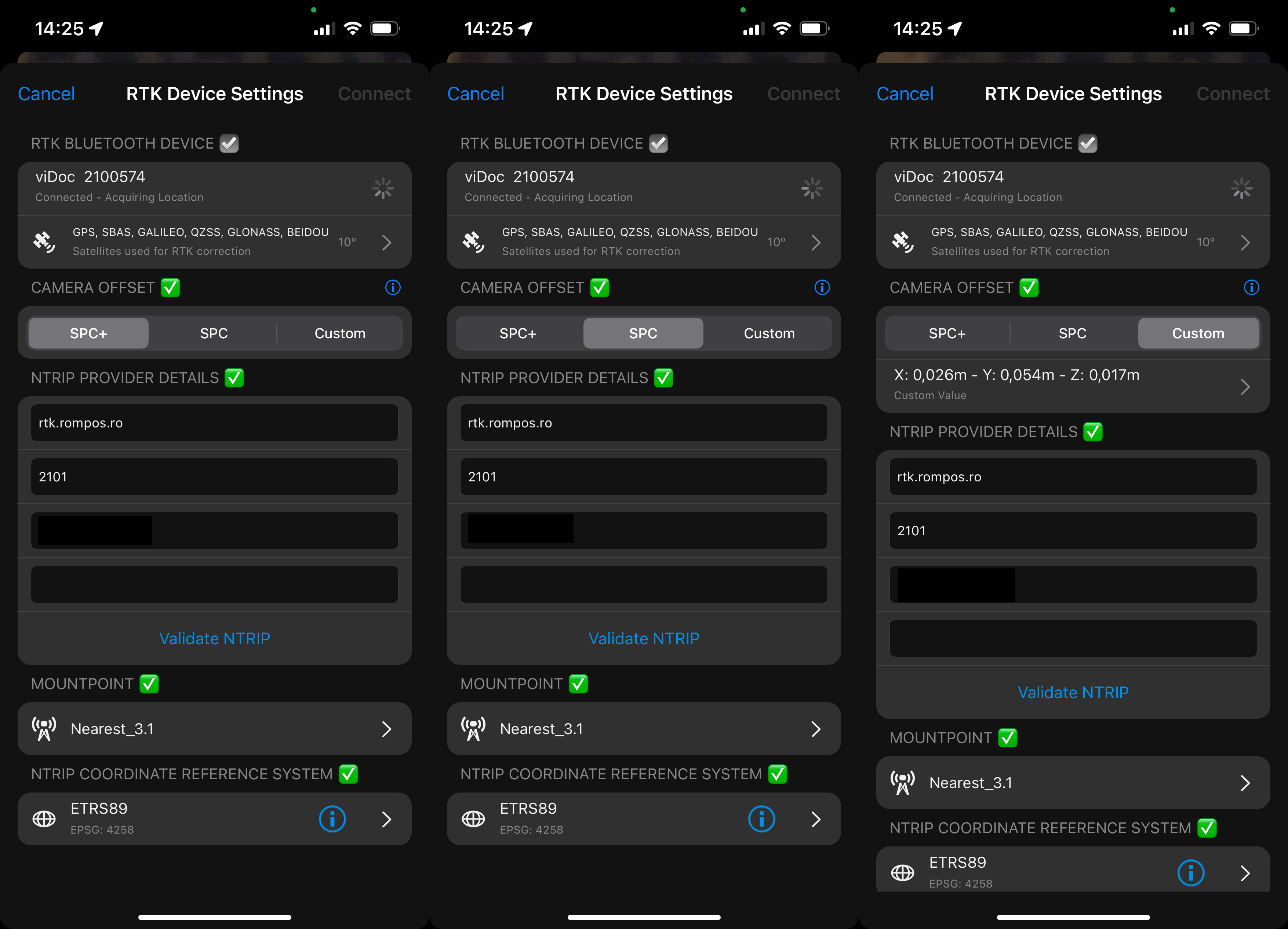

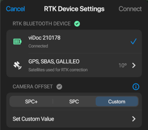

When initiating the connection to the PIX4D-supported RTK devices, the dialog RTK Device Settings opens. The section Camera Offset allows the user to set the X, Y, Z offset values properly. The available options depend on the combination of the viDoc distributed by PIX4D RTK device version, the mobile device and the device case. The following options are available: SPC, SPC+ (in tablet and older mobile app versions: Automatic) and Custom.
The options SPC and SPC+ are only available if the combinations of the viDoc distributed by PIX4D RTK device version, the mobile device and the device case are known. The option Custom is always available and intended to be used by universal or specific cases. This option requires measuring the camera offsets manually and setting them in PIX4Dcatch. The camera offset value selection is saved for the next measurements and modifications are only needed if the setup changes.

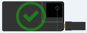

PIX4Dcatch_RTK__measure_z_offset_IPHONE_.jpgPIX4Dcatch_RTK__measure_z_offset_IPAD_.jpg
Mount the device to the PIX4D-supported RTK devices using the appropriate SP-connect case. Phone cases can be purchased separately from the SP-connect website. The SP-connect universal phone mount can be used if the specific model is unavailable. SP-connect cases are also available in most bicycle and motorcycle shops.
Place the device with the display facing forward. Note the orientation of the X, Y, and Z axes and how they relate to the point of origin on the antenna to measure from. The point of origin resides in the middle of the screw mount at the base of the antenna. It will also be necessary to determine which lens to measure from for devices with multiple camera lenses.

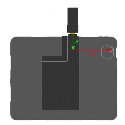

Important: If you use iPad, make sure the device is in landscape mode and the antenna is pointing upwards, like in the image above. The X and Y offset values must be entered as negative numbers.
Tip: If you don't know which camera lens to measure from, start PIX4Dcatch and then place something in front of each camera lens. The lens blocked is the appropriate lens to measure from.
Important: When using the universal mount, the lens and device must be below the antenna when mounting the device to the viDoc distributed by PIX4D.
PIX4Dcatch_Android_RTK_x_Not_Above_origin.jpg PIX4Dcatch_Android_RTK_check_Not_Above_origin.jpg

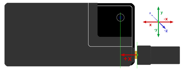

Measure the X-axis (Y-axis for iPad)
Measure the value from the antenna base to the center of the lens along the axis for the X-axis offset.
PIX4Dcatch Android RTK measure x offset diagram

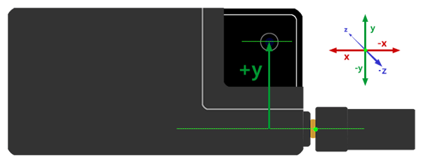

Measure the Y-axis (X-axis for iPad)
Measure the value from the center of the antenna to the center of the lens along the axis for the Y-axis offset.
PIX4Dcatch Android RTK measure y offset diagram

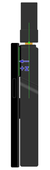

Measure the Z-axis
Measure the depth from the center of the antenna to the center of the lens for the Z-axis offset.
PIX4Dcatch Android RTK measure z offset diagram
Important: Most cases and adaptors add extra offset on top of the screen. Make sure that the Z-axis offset is measured to the lens and not the case/adaptor.

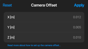

Enter the camera offset values
With the camera offsets properly measured and recorded, they can be included in the appropriate Camera Offset Values field of the RTK Device Settings dialog. Depending on the device's geographical region, centimeters or inches will be the displayed measurement unit.
Important: Ensure that camera offset values are defined in the correct measurement units. Setting the unit is available under the General settings -> Language & Region -> Measurement system.
The camera offset is now properly set in the Camera Offset Values X, Y, Z fields. Continue with the RTK Device Settings dialog to complete the viDoc distributed by PIX4D RTK connection to the device.
