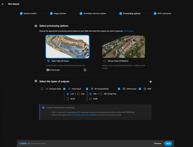

Select the processing options that are appropriate for the dataset.
PIX4Dcloud offers different processing options depending on the type of flight that the user would like to process. The recommended options are listed below:
Type of flight and dataset Recommended processing options
Nadir RGB images Nadir Flight (3D maps)
Oblique RGB images Oblique Flight (3D models)
Terrestrial RGB images(****) Upload from PIX4Dcatch
360 images Not supported
Multispectral images (*) Not supported
RGB images of agricultural fields
Nadir Flight (3D maps) with flat terrain
Thermal images (**) Not supported
Fisheye camera lens (***) Not fully supported
(*) Multispectral images are not supported. Processing in PIX4Dmapper or PIX4Dfields is recommended.
(**) Thermal RJPG images are not supported. Only thermal JPG grayscale images are supported but this is not recommended as the results may exhibit radiometric errors, scale problems, and calibration inaccuracies.
(***) It is possible to process Fisheye camera lenses, but they are not compatible with Gaussian splat processing and the virtual inspector tool.
(****) Processing datasets composed of aerial and terrestrial images (mixed datasets) is not officially supported. In these cases, it is recommended to process the terrestrial images as separate datasets and the aerial images as separate datasets.
Information: PIX4Dcloud alone doesn't support processing RJPEG images.
Warning:
  • Selecting the wrong processing option for your flight may lead to bad results.
  • Panorama 360 images are not supported for processing in PIX4Dcloud.
  • It is not recommended to process datasets captured with DJI Smart Oblique enabled. It is recommended to use the following mission types instead to ensure successful processing with PIX4Dcloud:
    • Traditional nadir single grid
    • Double grid with oblique images
    • Orbit, circular, or helix
For more information, see New dataset > Processing options - PIX4Dcloud.

PIX4Dcloud offers a default set of optimized options for processing.
  • Nadir Flight (3D maps): It is ideal for aerial RGB images acquired using a grid flight plan with high overlap, mostly oriented towards the ground. Typical applications are quarries, cadasters, etc.
    • Flat terrain: Ideal for RGB aerial images acquired using a grid flight plan with high overlap on flat terrain, for example, agricultural fields.
  • Oblique Flight (3D models): Ideal for any RGB images with a high amount of overlap, such as oblique aerial images (free flight). Application examples are 3D models of buildings, objects, inspection, etc.

PIX4Dcloud uses default parameters for processing.
PIX4Dcloud is a user-friendly web-based software designed for simplicity, eliminating the need for expertise in photogrammetry. It uses a set of default parameters tailored for various flight scenarios. These parameters are not adjustable.
Warning: There are instances where correct flights and high-quality images may still yield inaccurate results due to the limitations of default settings. In such cases, alternative software solutions like PIX4Dmatic can be used for greater flexibility in adjusting processing options.
Information: If a dataset does not fulfill the best practices or requires more than the capabilities explained above, the allowance or credits it consumed will not be returned.
