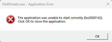

During the startup of PIX4Dmatic, the error 0xc0000142 appears and it is not possible to use the software.
Cause
0xc0000142 is a general error code for when Windows is unable to start an application correctly. One or more of the following may be the cause:
