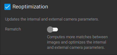

Reoptimization feature updates the internal and external camera parameters when new inputs, like marks on images, have been added after the Calibrate step has been run. It is a faster method for updating calibration and improving accuracy when compared to re-running the initial Calibrate step.
Reoptimization is always available but it is recommended to be used when there have been changes to:

Rematch
When enabled, this feature is a quicker method for computing more matches between the images, and therefore more Automatic Tie Points. Rematch is recommended to use when:
  • Trying to manually calibrate cameras that were not initially calibrated.
  • For difficult projects where few matches were initially found.
Note: This option will add more time to the Reoptimization process.
