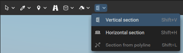

To access the Section view:
- From the toolbar on 3D view:
- Vertical section
- Horizontal section
- Section from polyline
- Section from planar polygon
- Vertical section

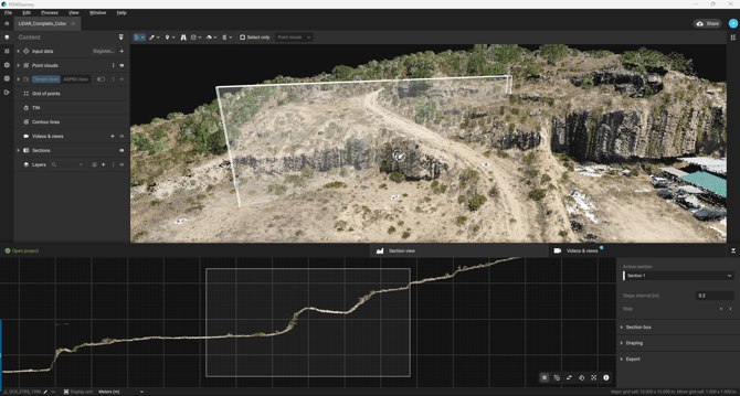

Adjusting the section box
The section box defines the visible area in the bottom panel. The half-transparent face represents the section plane, which faces the interior of the box. Ensure the plane is oriented towards the region intended for vectorization.
To adjust the section box, there are two options:
- From the 3D view: Provides a quick and rough box adjustment.
- From the bottom panel: Allows for precise adjustments of the box's height, width, and depth. The depth determines the visible area in the bottom panel, and this method offers greater control over rotation angles.

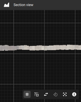

Information: The grid in the section can be used to have an estimation of the scale. There are major and minor lines. The distance between the lines can be seen in the bottom right corner. This value is automatically updated when zooming in or out.
Navigation:
- Use the mouse scroll wheel or pinch zoom on the trackpad to zoom into the section.
Click and drag with the mouse cursor to pan within the section. - To enable the ortho mode, click on Ortho button
- To snap to the point cloud, click on the Snap button
- To invert the direction of the section, click on the Invert button
. - To reset the view, click on the Reset view button
. This will reset the section view focusing on the profile box. - To rotate the section, click on the Rotate section 90° button
- For more information click on the Info button
