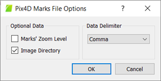

  7. (optional) If a Pix4D marks files (*.txt, *.csv) was selected, the pop-up Pix4D Marks File Options opens. Select the Optional Data to be exported and the Data Separator and click OK. For more information: Menu Project > GCP / MTP Manager... > GCP / MTP Table > Import / Export Marks....
Important: The following settings need to be applied for a seamless import into PIX4Dmatic:
  • File format: PIX4D marks files (*.txt, *.csv).
  • Marks' Zoom Level - unselected.
  • Image Directory - Selected.
  • Data Delimiter - Comma.
