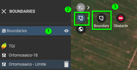

  1. Click Boundaries.
  2. Click the Draw boundaries icon.
  3. Select Boundary.
    2024-09-02_15-29-59
  4. Add Obstacles if needed.

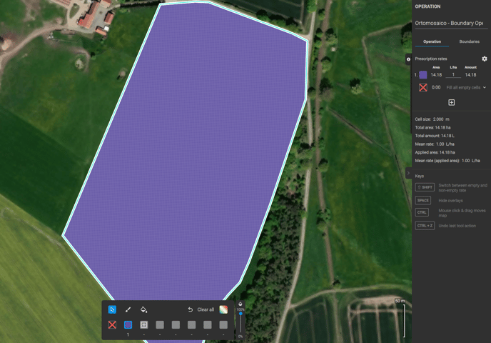

After creating the boundary, create a Targeted Operation by clicking Operation.
  1. Select Do not pre-fill grid cells.
    2024-08-30_13-41-00
  2. Select the Base layer and the Boundary.
  3. Set Units and Name of the Operation.
  4. Ignore the grid creation and click Continue
  5. Assign a rate, which can be changed in the remote controller as well.
  6. Click Fill all empty cells and select 1. Rate.
    2024-08-30_13-48-35
  7. Final operation:222
  8. Go to Export, Operations, DJI boundary mission.

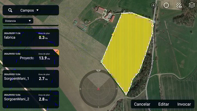

Import the boundary into DJI Agras controller
After exporting the desired format from PIX4Dfields:
  • Copy-paste it into the SD card.
  • Remove the SD card from the laptop and insert it into the DJI controller. Then, power on the controller.
  • Click on the SD Card icon, and choose Shapefile.
  • Select the proper boundary and click Import.
  • The boundary is imported and the application can be planned:WhatsApp Image 2024-09-03 at 13.40.56
