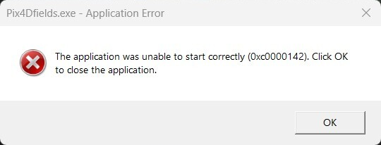

Error
During the startup of PIX4Dfields, the error 0xc0000142 appears and it is not possible to use the software.
Cause
Error 0xc0000142 is a general Windows error that occurs when an application fails to start correctly. One or more of the following may be the cause:
  • Antivirus/ security software interference: In most cases, this issue is caused by antivirus or security software blocking the application. Antivirus or security programs may mistakenly block applications and files required by PIX4Dfields to launch properly. It is recommended to add the exceptions listed in this article as a first step: Failed to authenticate.
  • Other causes include firewall, or system DLLs used by the Pix4D software are missing or corrupted
