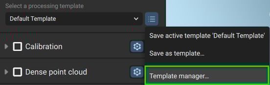

The first step is to select the desired processing settings across the processing steps:
  • Open a PIX4Dmatic project
  • Navigate to Processing settings  processing_options
  • Set the processing settings only for the processing steps needed: For example, it is possible to set the Calibration settings (Pipeline, image scale), the Dense point cloud (Algorithm, Image scale), and DSM (Resolution, Interpolation) without enabling the Mesh or the Orthomosaic.
  • Select the Template manager button list_view
  • Click on Save as template
  • Add a Name and a Description (optional) for easier management

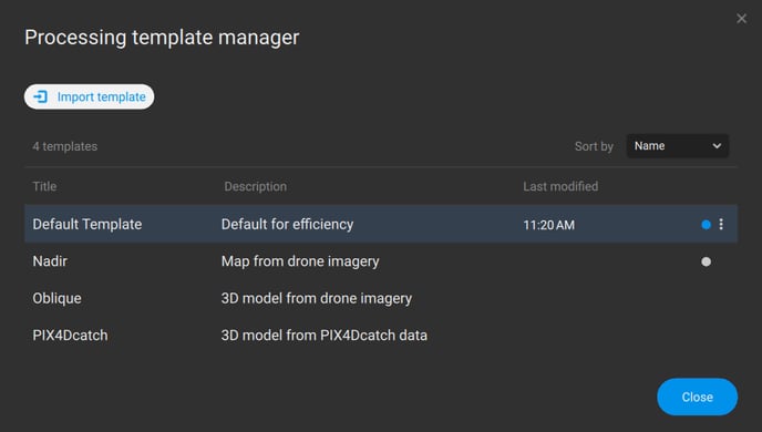

Template manager
The default and the custom templates are available in the Template manager:
The Processing template manager looks like this:
This window displays the Title, the Description, and the Last modified date and time for the custom templates. The blue dot indicates the active processing template and the grey one indicates the default processing template set by the user.
Import/Export
The Processing template manager gives the option to import and export a custom processing template. The file format for this is .json.
Before importing, the .json file should be opened in a text editor to modify its contents. Specifically, any folder paths or filenames should be removed. For example, "path": "C:\Users\Public\Projects\filename.las" should be changed to "path": "". After this modification, save it. Once the template is imported,  the template will automatically update with the new path for the current project.
To import a custom template:
  • Click on the Import template button
  • Navigate to and select the custom template (.json file)
  • Click Open
After importing, the new custom template will be displayed including the Title and the Description.
To export a custom processing template:
  • Click on the three dots on the right side more_vertical-1
  • Click on Export
  • (Optional) Name the .json file before clicking Save to the desired location
It is also possible to Set as default, Apply (set as currently active), and Delete a custom template by clicking on the three dots on the right side more_vertical-1
