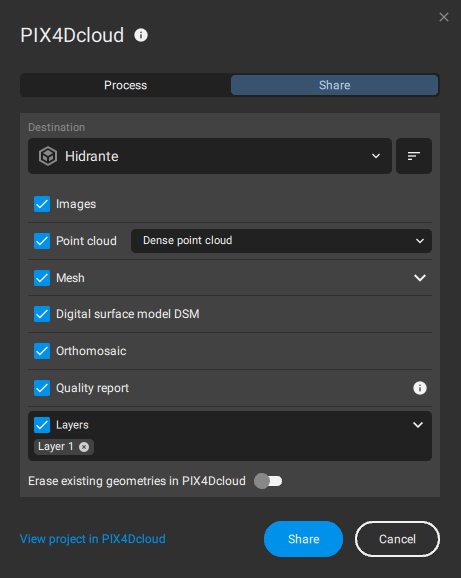

  • From the File menu select the Upload to PIX4Dcloud... option or click on the PIX4Dcloud button pix4dcloud_button, found at the top-right corner of the PIX4Dmatic window.

  • Select the project where the dataset will be uploaded.
  • Select the outputs for upload to PIX4Dcloud. The outputs that are available for upload are Images, Depth point cloud (for LiDAR PIX4Dcatch projects only), Dense point cloud, Depth & dense fusion (for LiDAR PIX4Dcatch projects only), Mesh, Digital surface model DSM, Orthomosaic, and Layers (geometries).

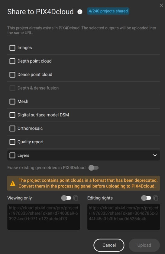

  • If the project has already been uploaded to PIX4Dcloud, the View project in PIX4Dcloud option will be enabled, allowing you to access the project directly in the cloud.

Point cloud file format and Upload to PIX4Dcloud
From version 1.67.0, PIX4Dmatic supports a new format for the point cloud (gLTF), making it easier to use the Share to PIX4Dcloud for larger projects.
  • For projects created using an older version, a warning message is displayed to convert the point cloud to the new format before using the Share to PIX4Dcloud.
Convert older point cloud to newer format

Important: All the point clouds in a project are merged into a single point cloud for the upload. The newly uploaded point cloud will always replace the previous one. The number of uploaded projects and the total number of projects that can be uploaded to PIX4Dcloud are displayed at the top of the Share to PIX4Dcloud dialog window.
