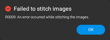

Error message
Failed to stitch images, R0009: An error occurred while stitching the images.
Description and causes
The error occurs after images are imported and the processing has started. PIX4Dfields normally reaches 27%, and is stuck, or it gives Error R0009. There are several reasons why this error can happen:

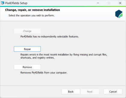

Corrupted installations
After installing a new PIX4Dfields version, some libraries can be missing, which will cause PIX4Dfields to fail during processing.
There is no need to uninstall the program, the projects will not be lost:
- Download the installer from: https://account.pix4d.com/download-software.
- Double-click on the installer.
- Click Next.
- Select Repair and click Next.
- Click Repair.

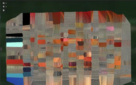

GPU acceleration is not supported
Out-of-date GPU drivers can cause PIX4Dfields to fail while processing, and images will be stitched incorrectly:
- To update the GPU driver, look up the latest model-specific version available: How to update graphic card drivers - PIX4Dfields
- If updating the driver does not work, process the imagery again, disabling GPU acceleration from the Processing options - PIX4Dfields
- For more information: Stitching artifacts - PIX4Dfields
