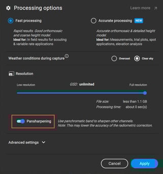

To enable pansharpening for applicable datasets with a panchromatic band:
1. Open a project and import images.
2. Under the processing option, toggle on mceclip0.png Pansharpening.
3. Click Apply.
Processing options Menu.

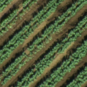

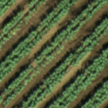

Cameras such as the RedEdge-P and the Altum-PT from Micasense come equipped with a panchromatic sensor. These cameras can create sharper orthomosaics which provide better visualizations for applications such as counting, scouting, and image analysis. The example below compares a pansharpend with a non-pansharpened image.
Pansharpening
No Pansharpening
