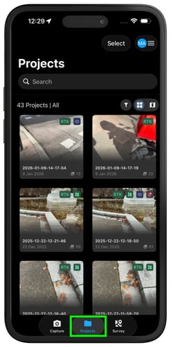

1. Tap the Project folder icon at the bottom of the screen.
   Project folder

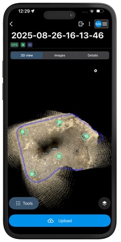

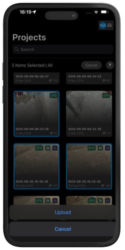

2. Select your project: Choose the project you want to upload using one of the following methods:

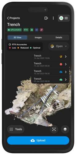

  • Tap the captured project to open it, then tap on upload iconUpload.

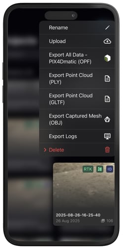

  • Press and hold the project to open the options menu, then tap on  upload icon Upload.

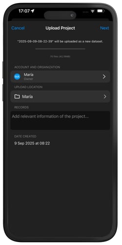

3.  Verify organization and upload location, then tap Next
  • Account and Organization:  Select the organization where the dataset will be uploaded. Processing credits will be deducted from this organization's account, and you can assign the dataset to a specific site.
  • Upload Location: Choose the destination site or folder within the organization.
  • Records: (Optional) Add project details or information that will appear in the final project overview.

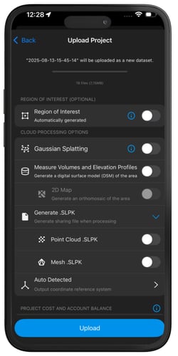

4.  Select processing options: Choose your desired processing configurations before initiating the upload. For more information, visit PIX4Dcloud processing options in PIX4Dcatch.

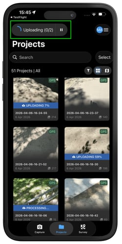

5.  Start the upload: Tap the Upload icon to send your project to PIX4Dcloud.

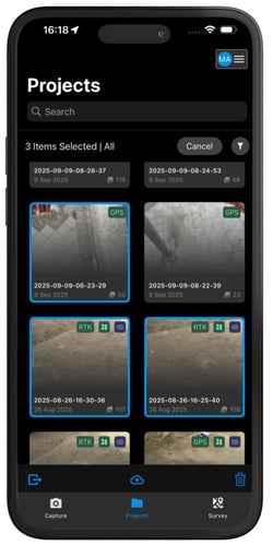

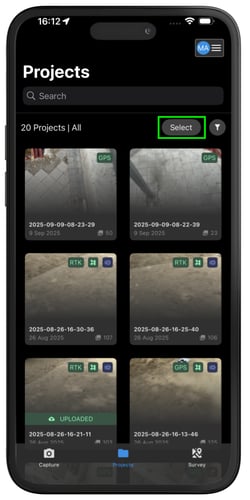

Advanced Cloud Features: PIX4Dcatch also supports multi-project uploads and reuploads to PIX4Dcloud. For detailed information, visit Multi-Project Upload and Project Re-upload.
  • Multi-project Upload: Upload multiple projects to PIX4Dcloud at the same time.
  • Project Reupload: Reupload projects with different processing options.
Note: In PIX4Dcatch, projects can be uploaded in the background, allowing you to continue capturing a new project without waiting for the current upload to finish. Uploads continue even if you close the app, provided your device allows background activity and has an internet connection.

1. Export from PIX4Dcatch: Export your captured project as an OPF (Optimized Project Format) file. This is the recommended format because it packages all necessary project data together, ensuring a complete and error-free transfer. For details, see  How to export PIX4Dcatch projects (iOS/Android).
