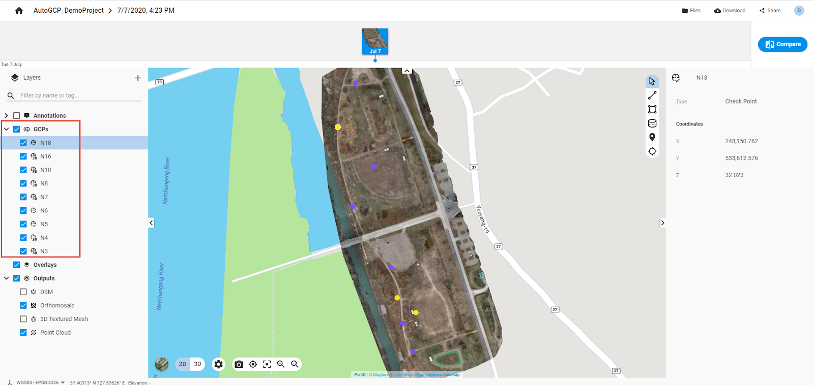

  • Open the dataset in the 2D or 3D view.
  • In the left panel, expand Layers.
  • The GCPs layer appears in the list when AutoGCPs detection has successfully identified control points.
Content of the GCPs Layer
The GCPs layer includes the following elements:
  • Ground Control Points (GCPs):
    Points detected and marked by the AutoGCPs functionality. These are displayed in    purple.3d_gcp.jpg
  • Check Points:
    Points detected and marked by the AutoGCPs functionality for independent accuracy validation. These are displayed in yellow. check_point.jpg
