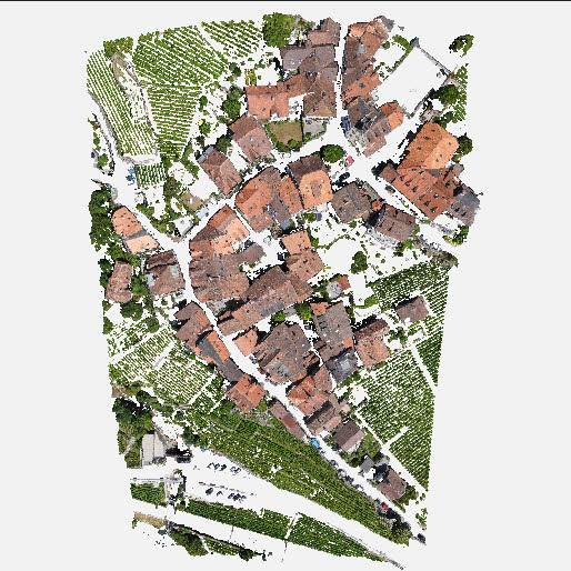

- All - default: All point clouds in the Content > Point clouds are used for processing.
- Only visible. Only visible point clouds in the Content > Point clouds are used for processing.

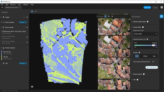

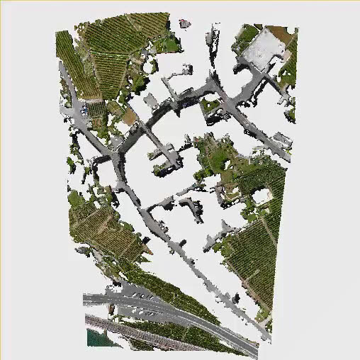

Example: When the Only visible option is selected, only the visible point cloud [ 1] is used for processing. Point clouds with visibility off (
) are not used for processing.

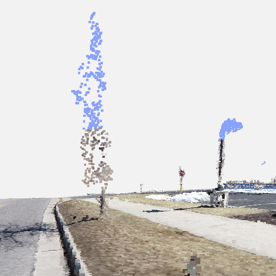

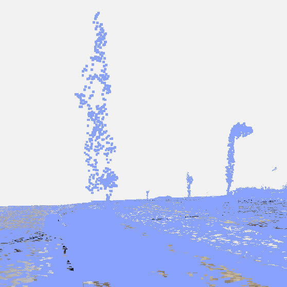

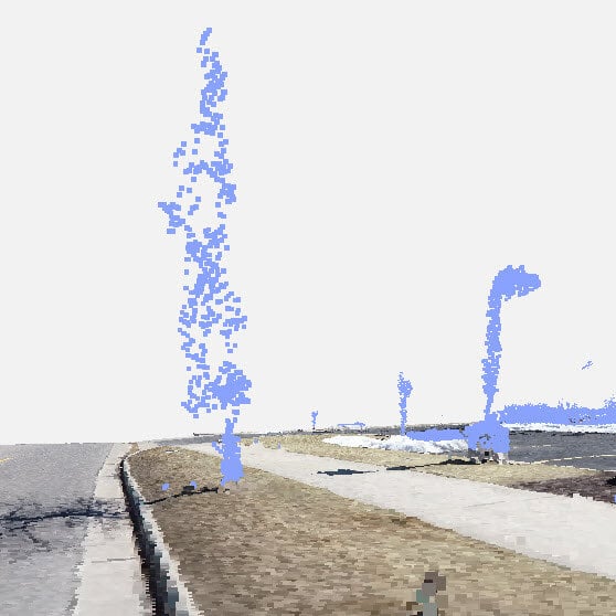

- Above Ground Threshold [units] (0.5 m, 1 ft - default): determines the maximum allowed distance between a point in the input point cloud and the surface generated based on the Sample distance and Rigidity parameters. The optimal value depends on the original density of the point cloud and on the quality of the reconstruction.

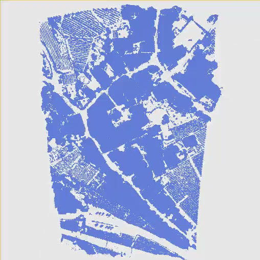

Example: Smaller Above ground threshold values include points closer to the ground into non-terrain class (blue color).

Access: Results of the Terrain filter process are available in the Content -
Terrain classes panel.

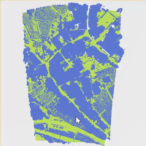

The following terrain classes are available:

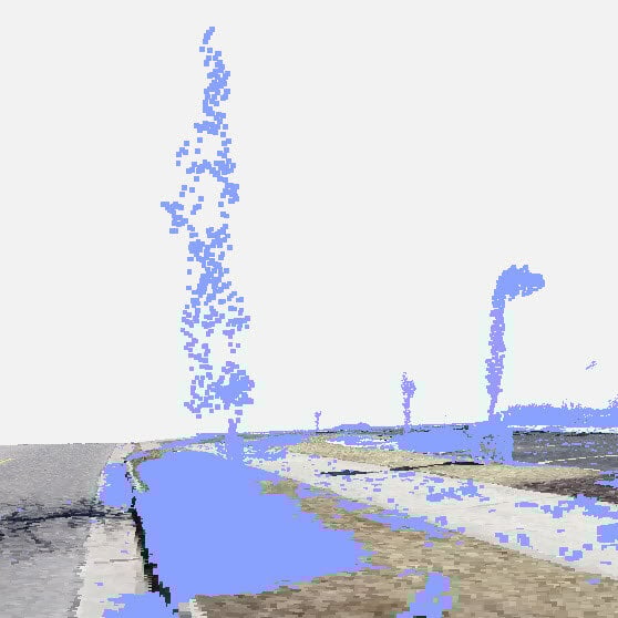

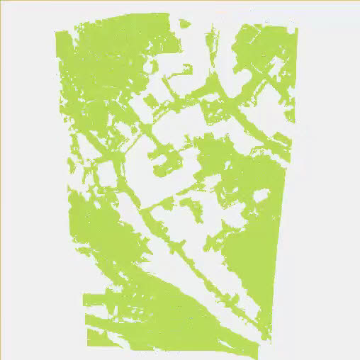

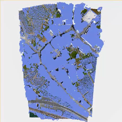

- Non-terrain (blue color): Points classified as non-terrain.
- Terrain (green color): Points classified as terrain.
- Never classified: Points corresponding to point clouds that were never classified.
To display terrain classes, both the Point clouds and Terrain classes visibility () need to be selected. If the points are turned off in the Point clouds section, that will overrule the display of the terrain classes.
