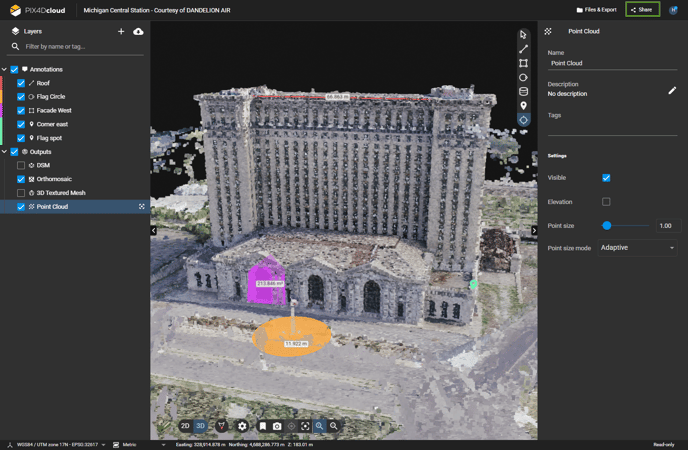

 Sharing a dataset
Michigan BH._v3

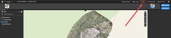

To share a dataset:
  1. Open the dataset to be shared.
  2. Select Share in the top-right corner of the viewer.
  3. Choose one of the available tabs:
    1. LINK for share links
    2. EMBED for embed links
  4. Enable the required sharing option.
  5. Copy the generated URL or embed cod

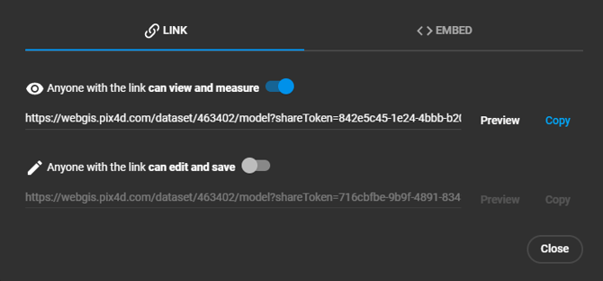

Share LINK URLs
LINK URLs provide access to the dataset through an interactive web browser view.
Depending on the selected permission level, collaborators can visualize results, perform measurements, analyze data, and create or save supported annotations.
Two LINK URLs can be generated for each dataset:
  • View and measure only
  • Edit and save
The View and measure only LINK URL is intended for collaborators who need to visualize and analyze results without saving changes to the dataset.
Collaborators can:
  • Open the dataset without logging in.
  • View 2D and 3D results.
  • Create temporary measurements and annotations.
  • Modify supported layer visualization settings, such as visibility, opacity, and background color.
Changes made through this link are temporary and are discarded when the page is refreshed.
This option is recommended when customers or collaborators only need to review, visualize, and analyze project results.
Edit and save
The Edit and save LINK URL allows collaborators to make and save supported changes while accessing the dataset through the shared link.
Collaborators can:
  • View and analyze data using available 2D and 3D tools.
  • Create and edit supported annotations and measurements.
  • Modify supported layer visualization settings.
  • Save supported annotations, measurements, and visualization changes.
Saved changes remain available after the page is refreshed.
Note: Edit and save does not provide full dataset editing or management access. It allows collaborators to save supported annotations, measurements, and visualization changes, but it does not provide access to dataset management, image or file upload, processing, or downloading and exporting outputs.

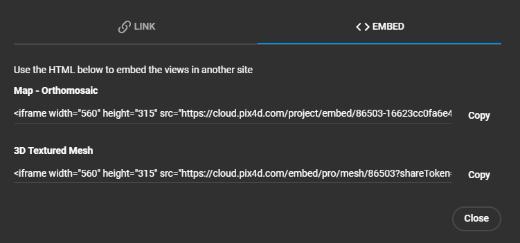

Embed URLs
EMBED URLs allow PIX4Dcloud results to be displayed on external websites.
The HTML code can be copied from the EMBED tab and added to a supported external website.
Behavior of EMBED URLs
When using an EMBED URL:
  • Results are available for visualization only.
  • Measurements and analysis tools are not available.
  • Annotations are not displayed.
  • Orthomosaics and 3D models can be viewed interactively.
The embedded content is served from a cache with a duration of 24 hours.
EMBED URLs are recommended when the goal is to display PIX4Dcloud results to website visitors without providing interactive analysis, annotation, or dataset access.
