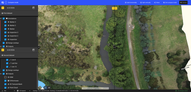

  1. In PIX4Dcloud Pro, open a Site from the Drive.
  2. Select a dataset in the timeline.
  3. In the upper bar, next to the timeline, click Compare to activate Compare mode.
  4. In the bottom-right corner, select the desired view (2D or 3D).
  5. The initially selected dataset is shown as Dataset 2 (icon_2.png) by default.
    • Click the calendar icon (calendar.png) and select a second dataset date to define Dataset 1 (icon_1.png).
  6. Once both datasets are selected, they are displayed in the selected view, separated by a comparison slider.
    • Move the slider horizontally or vertically (depending on the split mode) to compare results.
    • Zoom and pan to inspect details.
      Screenshot 2026-10-14 at 15.46.12
  7. (Optional) Change either dataset at any time using the date picker.
  8. To exit Compare mode, click Exit compare mode in the upper bar.
