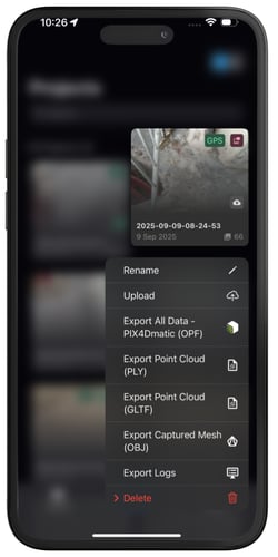

  1. Launch the PIX4Dcatch app.
  2. Tap Projects at the bottom of the screen.
  3. From the Projects tab, either:
    A.  Long-press on the selected project to open the export dialog.
    B. Open the project and tap the export menu export icon located at the top of the screen to view different export options.
  4. Then, select the desired data to export (OPF, PLY, OBJ, or Logs).
  5. A new window with sharing options will appear. Select the destination.

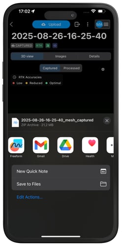

  3. Export the data as described above.
  4. In the window with sharing options, select Save to Files folder icon.
       5.   Select FLASHDEVICE and click Save.

Export using a cloud file-sharing platform
A cloud file-sharing platform, such as Google Drive, OneDrive, Dropbox, or Box, can be used to transfer exported files from PIX4Dcatch.
  1. In the Export dialog, select the desired file-sharing platform.
  2. (Optional) After selecting the file-sharing platform, select the destination folder.
  3. Tap Upload.

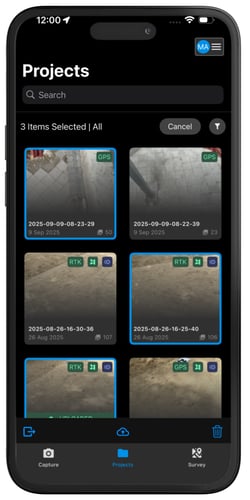

Bulk transfer of projects
PIX4Dcatch allows for the export, upload, and deletion of multiple projects in a single operation.
  1. On the Home screen, tap Projects.
  2. On the Projects page, tap Select to enable bulk selection.
  3. Tap and highlight the desired projects to bulk export, upload, or delete.
  4. Choose one of the following actions:
    Export projects: Tap Export at the bottom-left of the screen to export multiple projects at once.
    Upload projects: Tap Upload   in the bottom center to upload multiple projects at once.
    Delete projects: Tap the Trashcan icon at the bottom right to delete multiple projects at once.
