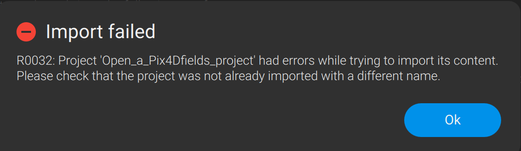

Error
"R0032: Project 'Name of the Project' had errors while trying to import its content. Please check that the project was not already imported with a different name.
