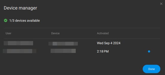

Device manager
Starting from the 1.67.0 version of PIX4survey a powerful feature aimed for enhanced license management has been added. It is now possible to monitor and control devices connected to the PIX4Dsurvey license.
How to Manage Devices
To manage connected devices:
  • Navigate to userAccount in the top right corner.
  • Click on monitor Device Manager:
    • The total number of available devices is listed.
    • A comprehensive list of all devices connected to the license will be displayed, including each device's name for easy identification.
  • Remote Deactivation: If needed, it is possible to free up a license seat by selecting the Reclaim Seat option for any device on the list, instantly deactivating the license on that device.
Note: The release of the seat may take a few minutes.
  • Click Done
