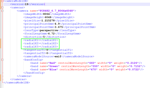

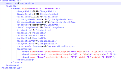

If PIX4Dreact displays a message that the XML contains errors, please:
- Ensure the provided XML has the correct format:
- Ensure there are no empty tags:
- Ensure there are no incomplete tags like <rigs/> at the beginning or <mappings/> at the end.
