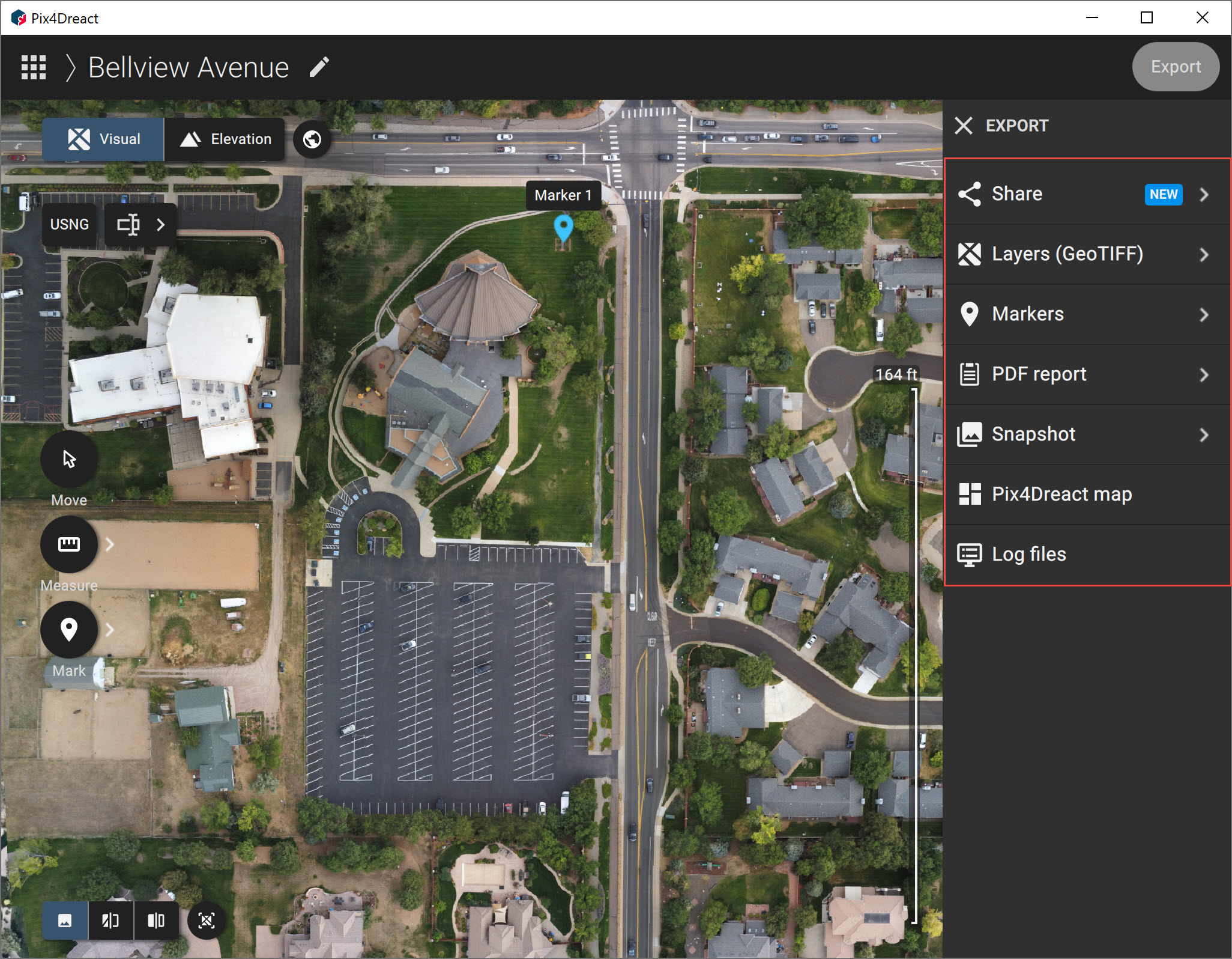

PIX4Dreact can export these outputs which can be used outside the software or shared with external stakeholders:
- Share to PIX4Dcloud: A platform for easy-to-share 2D maps for enhanced collaboration. For more information visit the Share to PIX4Dcloud support documentation page.
- Layers (GeoTIFF): 2D visual or elevation map generated by blending multiple orthophotos. The orthomosaic is color balanced and georeferenced. Export options include the ability to reduce the image size (MB). This includes a reduced image scale for a lower a megabyte image in addition to using overviews (image pyramids). Overviews provide a more responsive viewing experience in third-party image applications, but require extra disk space.
- Markers (GeoJSON, Shapefile (.zip)): Vector files which include the geometry features Point, Line, and Area.
- PDF Report (.pdf): Low-resolution version of the orthomosaic which contains an overview of the map. Optionally, the surface model and markers can be exported and displayed together or individually.
- Snapshot (.jpeg, .png): Image of orthomosaic with or without markers and basemap.
- PIX4Dreact map (.p4r): Map files used for importing into PIX4Dreact on another computer. These files include a .p4r file which contains information about the map, a snapshot of the orthomosaic (.png), the orthomosaic (GeoTIFF), the surface model (GeoTIFF) and the markers (GeoJSON).
