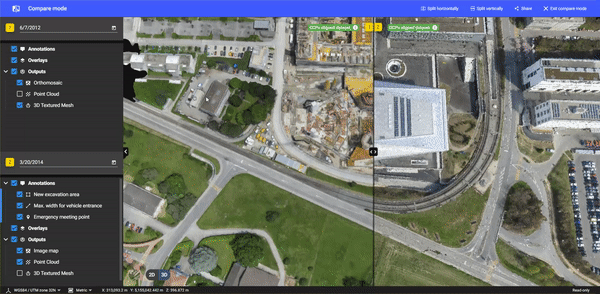

  4. In the bottom-right corner, select the desired view (2D or 3D).

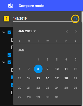

  5. The initially selected dataset is shown as Dataset 2 (icon_2.png) by default.
    • Click the calendar icon (calendar.png) and select a second dataset date to define Dataset 1 (icon_1.png).
  6. Once both datasets are selected, they are displayed in the selected view, separated by a comparison slider.
    • Move the slider horizontally or vertically (depending on the split mode) to compare results.
    • Zoom and pan to inspect details.
  7. (Optional) Change either dataset at any time using the date picker.
  8. To exit Compare mode, click Exit compare mode in the upper bar.

  • Only dates with available datasets can be selected.
  • If multiple datasets exist on the same day, the capture time can be specified.

Note: Two view modes are available: vertical vertical_split_mode.png (default) or horizontal split_mode.png. Switching views is possible at any time, clicking the corresponding mode icons.
