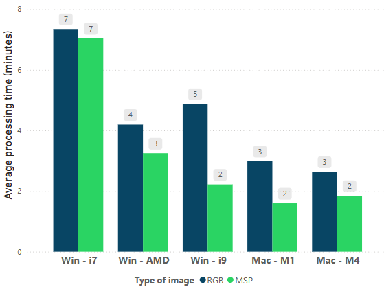

Fast processing pipeline
MacBooks (M1 and M4) deliver similar total processing times for the fast processing pipeline,  beating the Windows options.
Fast_3
  • The data show that in the Fast processing pipeline, even a modest Mac M1 or a mid-range Windows CPU/GPU can produce results in just a few minutes.
  • For example, macOS M1 averages ~5 minutes (MSP + RGB). That’s very fast compared to the high-end i9 system (~7 minutes) or AMD (~7minutes).
  • This implies that an expensive, top-of-the-line machine is unnecessary to run the fast pipeline quickly. A cheaper i7 (or an M1 Mac) could suffice if fast processing pipeline is used.
💡The fast processing pipeline is ideal for a wide range of work scenarios, as it achieves geolocation accuracy comparable to that of the Accurate processing pipeline, while significantly reducing processing time. It is recommended to use Accurate processing pipeline only when a detailed DSM is needed.

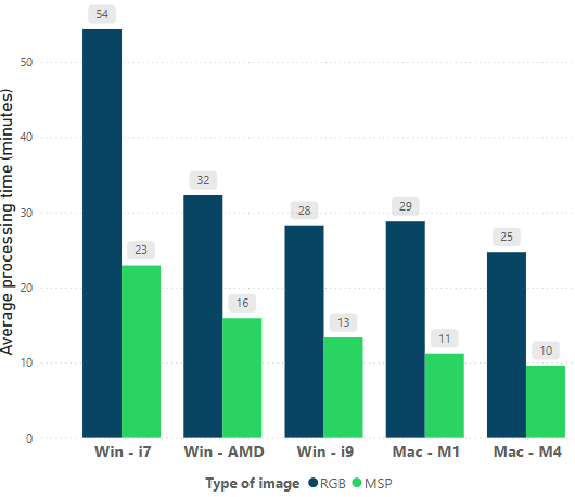

The Mac M4 was the fastest processor for the accurate processing pipeline, followed very closely by the Windows i9 machine and Mac M1.
Accureate_3
  • When Accurate processing is needed due to the need for a detailed Digital Surface Model, differences in machine capacity are more remarkable.
  • In such scenarios, utilizing a more powerful machine can significantly reduce processing times, potentially saving you tens of minutes or even hours on larger projects. If you frequently undertake substantial accurate tasks, investing in a mid-range to high-end system could prove beneficial.
