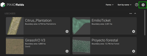

Where are projects stored?
Projects are saved/stored in the Data Storage Folder. To access it:
1- Go to Settings on the top-right:
AccessHomeSettings
2-
 Click on the Data storage folder to see where the projects are stored.
  • All projects and files generated will be stored in this folder. Several file types will be present
  • To modify the storage location of your projects, select a different folder in the Data storage folder settings. Changing your data storage folder will not move existing projects to the new location.
  • To move projects, please read: How to manage projects.
