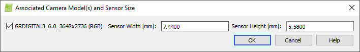

7. (optional) If a Bingo text file (*.txt) is selected, the Associated Camera Model(s) and Sensor Size pop-up appears. Select the associated camera model and edit the sensor width and the sensor height, if they are not detected correctly.
